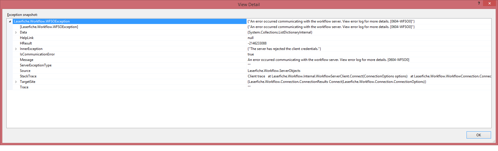

An error occurred communicating with the workflow server. View error log for more details. [0604-WFSO0]
Please see the view details screenshot attached.
View Details.png (23.93 KB)
