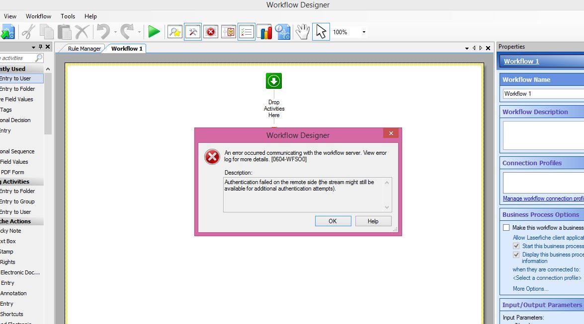

When opening Workflow Designer 9.1 or Workflow Administration 9.1 console on my local machine, I receive an error message that communication failed with the Workflow Server. This problem randomly happened to my local machine and no other machines on the network with the Workflow software installed.
Error Message:
An error occurred communicating with the workflow server. View error log for more details. [0604-WFSO0]
Description:
Either the target name is incorrect or the server has rejected client credentials.
Not sure if this may have been caused by updating from 9.0 to 9.1. Does anyone have any ideas on what may be causing this and how to solve this problem?

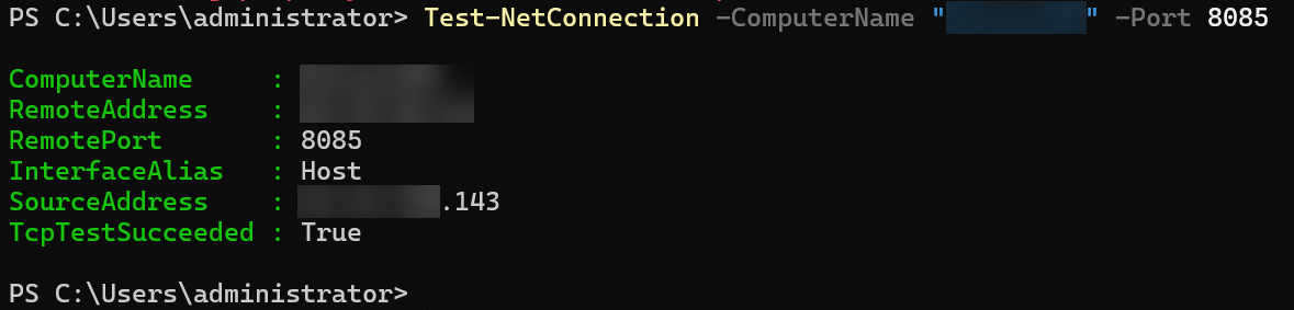

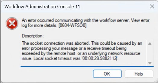

I am seeing a similar error message on a system. While the error number is the same, the message is slightly different.
We have tried disabling UAC on the Workflow Server, but it did not resolve the issue. We have verified that the machine the Workflow Designer is installed on can connect to the Workflow Server with the following:
Any other ideas of what might be causing this issue?

replied on June 18, 2025
Can you get a support case going so we can take a closer look? Is it machine specific? Is it intermittent on this machine?
