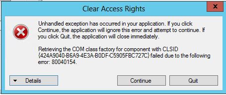

Hello Brianna,
when using the tool, i'm getting this error below
Laserfiche license manager 8.3.1
administration console 9.2
any idea
replied on August 6, 2015
You need the LFSO8.2 run-time files installed for the pre-built 82 executable to run.  My guess is that you do not have that on your system.

replied on August 7, 2015
If you have the SDK, then you can just install the 9.x runtime and it should install the 8.2 runtime as well.  If you do not have the SDK, then I will have to defer to someone from Laserfiche or your VAR to provide it for you.
