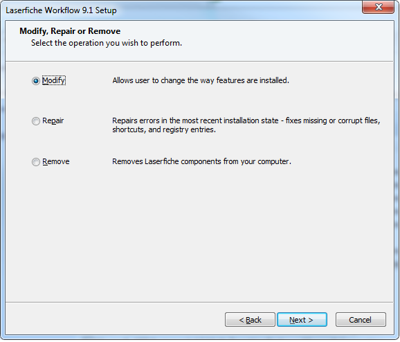

I can't seem to find a repair option in Programs or using the Laserrfiche installer. I can't find this file on my computer to replace it. I can't uninstall because it needs the assembly. I can't re-install because it thinks it is successfuly installed.
replied on July 16, 2015 Show version history
You can repair the installation to get back the missing files by clicking Change on the LF Workflow entry in Programs and Features. It detects WF is already installed and gives you these options on the next step:

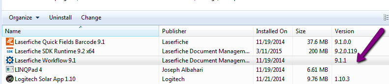

What is listed for Laserfiche Workflow under Programs and Features in Control Panel?
replied on July 21, 2015
Just Laserfiche Workflow
I finally got it working again. I had to use the workflow 9.2.1 installer instead of the 9.2 installer and it works with a 9.2 engine. Not sure if that is preferable but it was the only thing that worked.
replied on July 22, 2015
Sounds like you already had 9.2.1 installed. The version column would indicate the minor version too.
