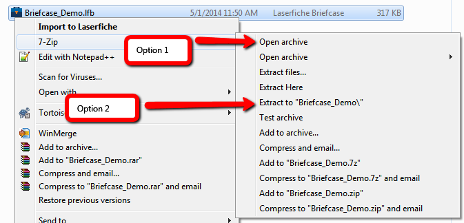

Using 7-zip, I can extract briefcases both with and without changing the extension. I can also view the contents. Here's some screenshots that might help:
When you install 7zip, you should get a context menu like shown here. You can choose to open up the archive using their archive viewer (good for a quick peek at the contents) or to extract it. I like the extract to "Name Here\" option because it creates a folder for you to keep all your documents together, but all of the Extract options should work.
Assuming you choose the Extract option, you'll get something like this:

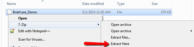

What's going on here is that you've unzipped the gzipped file and now have the tar file. Fortunately, we can use 7zip again:

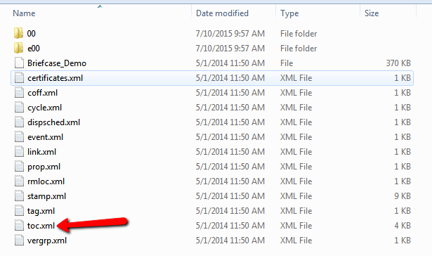

And now you should have something like this with your toc.xml:
