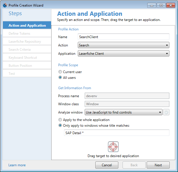

replied on August 26, 2015 • Show version history
We had Connector grab the SAP Login Pad, and then tried to change the window title to match the second detailed screen but weren't able to detect elements on the next screen where tokens are created as it still wasn't detecting the window.  **Note the process name and class are not accurate as I selected a different application for demonstration since I do not have SAP on my machine ;).
We're exploring the accessibility plugins and fairly confident your suggestion will work. Will post back when we get it working.
