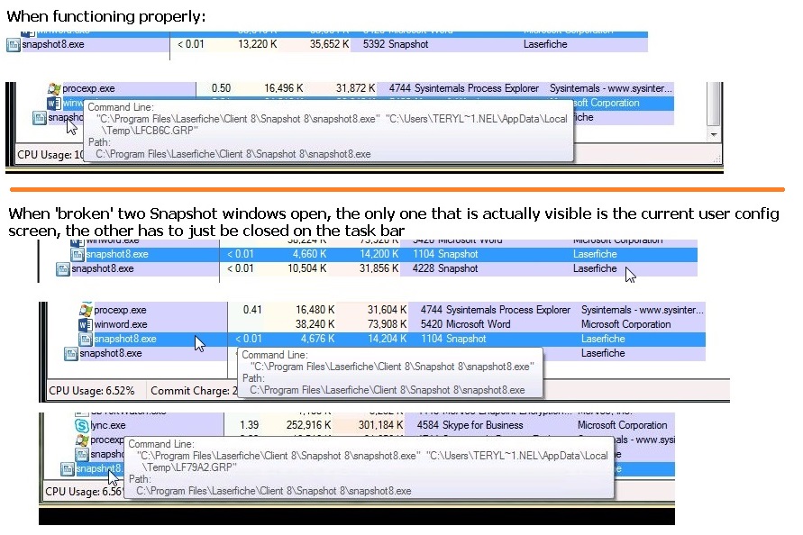

replied on August 18, 2015
Wanted to give an update/resolution found to this topic... turns out that the issue is due to our telecommuting users having a different monitor model as their second monitor at home vs. the model being used when in office.  When they were switching betwen locations, it was looking for the same monitor that they used when they did the first time set up and not finding it.   We resolved the issue by having them always have the Snapshot window on their main/laptop monitor.

replied on June 18, 2015
Ok - we were able to capture when a user was both broken and then after I had her functioning again.  Screen prints attached.  The .grp being passed is different in each.
replied on June 8, 2015
Snapshot should present the print UI if it's passed a file path that has a ".grp" extension on the command-line. Using Process Explorer one can examine the command-line arguments used to start a program. The next steps to debug the issue would depend on whether the command-line arguments are correct or not.
