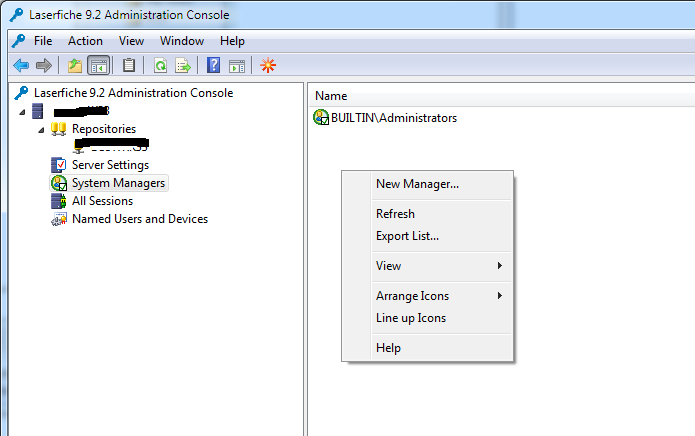

replied on May 28, 2015 • Show version history
Jim,
Make sure you log into the admin console on the server first, then add the desired users to the System Manager node.  This will allow them to see the Named users and Devices node from any admin consoles after that.
*Make sure that the windows account is correct.
