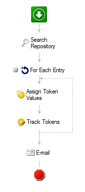

I am trying to write a workflow that will search a set of subfolders and list them (as an example), basically a list of everything that meets a certain condition (i.e. for each result from a Search Repository or Find Items task).  I did find this post here, and it started me in the right direction, however I don't think I'm quite there...

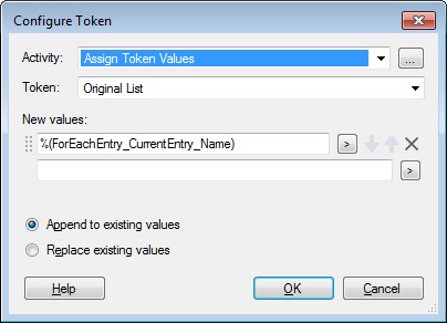

What I've done to this point is do a search on our test repository for folders, and for each one it finds, append it to a multi-value token (my Assign Token Values task in the attached image).  Using the Track Tokens task, I can see that each iteration through the loop adds the folder name (CurrentEntry) for that loop to the token value, but I can't tell if it updated the single value, or appended a new value?

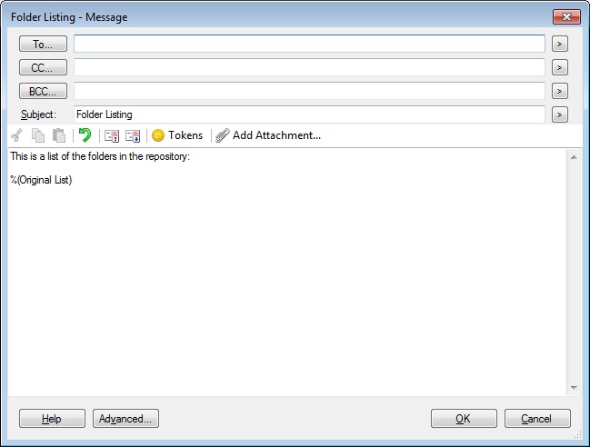

At the end of this loop, I did up a test Email to send out this list of all values, however it only sends out the last folder value, which tells me the token is getting overwritten each time I'm stepping through the loop, not appending the value as a new value to the multi-value token.

replied on April 24, 2015
Create the token before you go into the For Each loop. Then append in the loop. Your current setup is basically re-creating the token for every iteration.
So I moved the original token creation outside of the loop, made a copy of it into the loop, and set it to take the assigned "Original List" token value, and append the current entry name (folder name) as a new list item.  Looking at the results, I can see the multi-value token building the list correctly with each iteration, however when I try to reference the token in an Email message, it still only shows the first item in the list.
Since your token is multivalue, try using
%(Original List#[]#)
in the e-mail
I had absolutely no idea that Token Editor existed within an Email message, that's fantastic - I'll be using this one regularly!
Thanks much!
Marty
It actually exists anywhere in workflow where there is a token, so long as it's text... which means almost everywhere. Token menus also have a "Token Dialog" which is basically an extended version of this.
