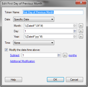

Hi Eric,
Please refer to this previous thread which explains the concept of how this can be done using the date token calculator.

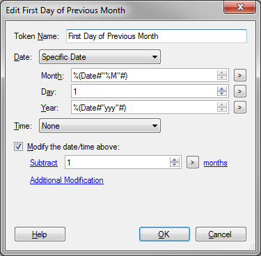

First Day of Previous Month:

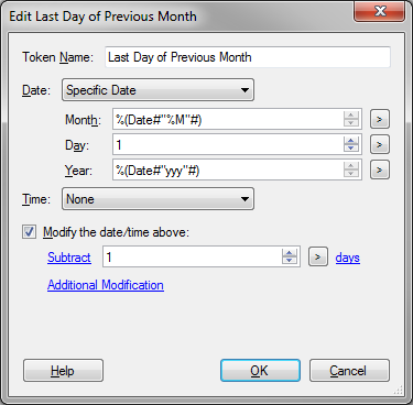

Last Day of Previous Month:

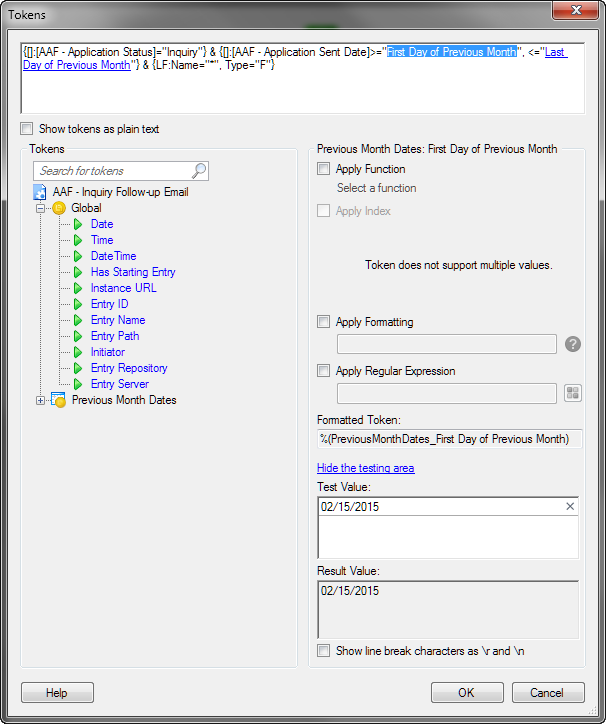

Thank you Alexander. However, this ins't working for me for some reason. I believe I have the token created exactly how it is shown in your screenshot but when I test the token, it does not alter the date that I enter for the test. Ex: If I test the token and enter 02/15/2015, the result is the same date as what I started with.
Here is a screenshot from my token configuration:
And a screenshot of the test whenever I test it from the search where I have the tokens embedded:
Any observations you have would be helpful.

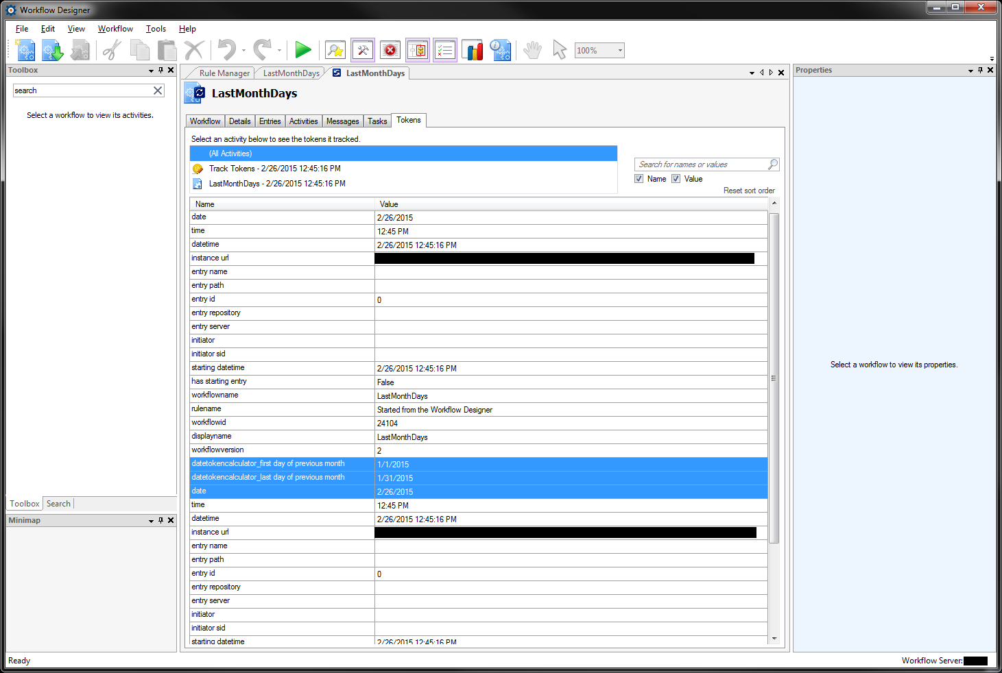

The testing area in the token dialog only applies to any functions, indexes, formatting or regular expressions you had applied to that token. Instead, use a "Track Tokens" activity and perform a generic test of the workflow by running it directly in the designer. My test workflow just has the date token calculator activity and track tokens. When I run the workflow in the designer, this is the result:
replied on February 26, 2015 Show version history
Ahhh.... ok, that worked better. The full business process I have will be emailing to all the the returned search results and since that would be over 100, I didn't want to run the actual process. I copied the Date Token Calculator and the Search activities to a new workflow and then ran it separately. My results matched what I was able to search for in the Laserfiche Client so it is working perfectly!!
