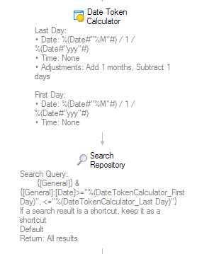

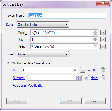

I assume you'd want this workflow to run on a schedule once a month. Date Token Calculator lets you find the last day of the month. The first day of the current month is relatively easy, you just replace the day with 1 on the current date. Or if this workflow runs on the 1st, it's just the current date. For the last date, if you add a month to the first of this month and then subtract a day, you get the last day of the current month.
Then you can use the 2 dates in the search.

Awsome thanks, would have taken me forever to think of that.
