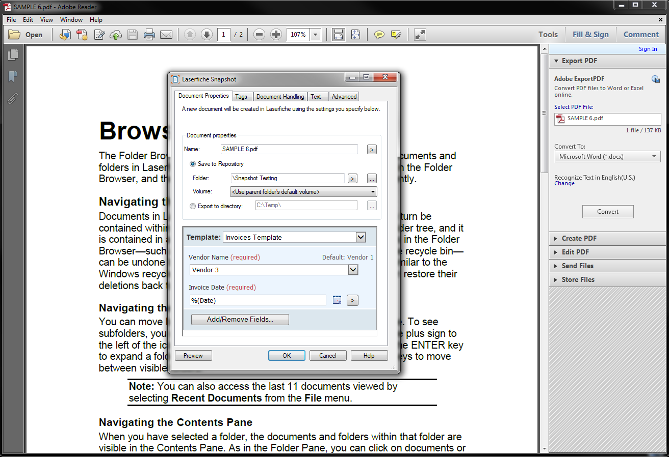

To clarify, are you having an issue going into the Laserfiche Snapshot Confiugration and setting a template to use by default with a specific Vendor value filled in the vendor field? Or is the issue the inability to change the field value away from the default?
In the below screenshots, this is how you would normally have things configured where you set a default template and field values and then not have to manually specify them after each Snapshot print job.
If you are wanting the ability to be able to modify the field values after a print job and use something different than what's set by default, then you would want to use the option "Prompt to configure properties"
If I'm still not understanding the issue you're experiencing, please provide additional details to add more context. Another option may be to contact your Laserfiche reseller to open a support case if that's easier for you.
Regards

I want to be able to modify additional field values such as the invoice number and amount as well as the approval status.  Currently, if i set the values that I want to be maintained on every print job that is done, i am no longer able to.  It sets all values back to the original default of the template. As the example below, the only way to get Livestock Express to stay as the vendor, is if I change the default for the field.
