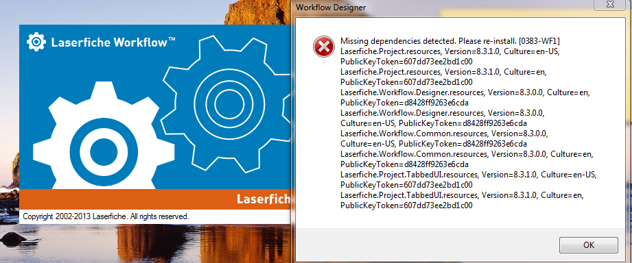

In running workflow designer, a following error occured: "Missing dependencies detected. Please re-install. [0383-WF1]
Can anyone help me?
Find a print screen of the error in attachment.
Thank you

You would normally get this if your WF Designer Profile is corrupted.  Please go through the following steps exactly as detailed:
  1. Open Windows Explorer and go to
  2. C:\Users\Yourusername\AppData\Local\Laserfiche\Laserfiche.Workflow.Desig_StrongName_muzewfif0xyihnye3w32xtk44w2p0pkg
  3. There should be a folder there named "8.3.0.0". Delete it and all its contents
  4. Uninstall the WF Designer
  5. Browse to c:\Program Files\Laserfiche\Laserfiche Workflow 9 and look for the file Laserfiche.workflowdesigner.exe.config
  6. IF it is there, delete the file "Laserfiche.workflowdesigner.exe.config" Do NOT delete anything else.
  7. Reboot
  8. Reinstall the WF Designer

replied on February 11, 2015
I forgot to specify that this has occurred during the installation of the Demo

Please open a case with Support and attach a screenshot of the message together with your application, system and LFworkflow event logs.
replied on February 14, 2015
Thank you all. The problem is solved. I was installing LF workflow9.0 and by installing LF Workflow9.2 the error disappeared.
