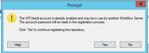

We have taken the repository from PROD environment and restored to TEST environment, also ran UUIDupdater.exe on the db. Everything seems to be working fine, but when trying to "Add" (not Attach) the repository to the TEST workflow server (not the PROD workflow server) through workflow configuration, the following warning popped up. Should we use "Attach" instead, or there is something we missed?
