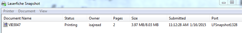

Yes, I do have it set as my default.  I should also add that I can pull up the printer window and see it "printing".  But the prompt never shows up and it never actually saves it anywhere.

-When I try to print a specific pdf to LF snapshot it brings up the dialog box, when she tries to print the same pdf to LF snapshot it gets stuck in the printing queue (just like your screenshot above)

-It seems to be how LF is communication with the print queue, it's just getting stuck and never making it to the dialog box on that one machine.
