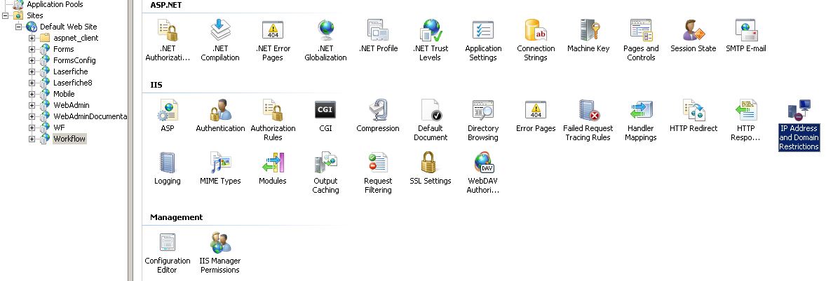

I know IIS can be setup to allow a specific IP address, Network range, or even Domain name.
The little VS2010 .NET project will only work though when it is executed directly from the workflow server itself.  I am wondering how to change the authentication on the Workflow Web Service to allow a specific IP address to call the workflow web service from another web server, or let the Visual Studio 2010 .NET Project run on a machine other than the workflow server itself.  When I enable Anonymous Authentication and add a local IP subnet as allowed, the .NET project encounters the security exception requesting NTLM or Windows Authentication.
