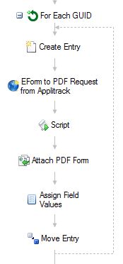

Ed, so would I do something like the following:
When I try to tell the Attach PDF Form activity to Attach a file from the "EForm to PDF Request from Applitrack" activity, the script is not available to select from. How would I accomplish that?
You shouldn't need the attach pdf form activity in this sample since the script is doing that work already.

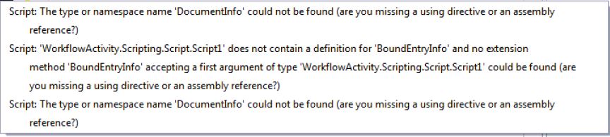

Ed, when I try add the Script activity and then add what you posted into the Script Editor where it says 'Write your code here, it gives me a bunch of errors when I hover over the exclamation point. Am I supposed to be entering what you posted a different way into the script activity?
Also, how to I do I tell the script to process the byte array that is returned from the "EForm to PDF Request from Applitrack" activity? Here is a screenshot of what I have currently:
What do the errors say? Stuff like "'String' is a class type and cannot be used as an expression."?
Ed's code was in C#, your activity seems to be using VB.NET.
I switched it to C# and that seems to have gotten rid of some of the error messages, but now I am seeing things like "namespace stringready could not be found" or "namespace xmlreader could not be found".
Add a reference to System.IO to your script. Then at the top in the using statements, add
    using System.IO;
    using System.Xml;
That got rid of most of the errors. I now have 3 left.
The script above assumes WF 9.1.1. Are you running 9.0.2 or lower?
No, we are running the latest version of 9.2.
We got the errors figured out. We were not using the SDK script activity. A couple of other questions on this though. Does the script attach the PDF to the entry created in the "Create Entry" step of the workflow or do I need to change something for that to happen?

Thank you everyone for the help. Below is the completed Workflow we came up with for our needs based on the feedback here:
And below are the contents of the SDK Script:
