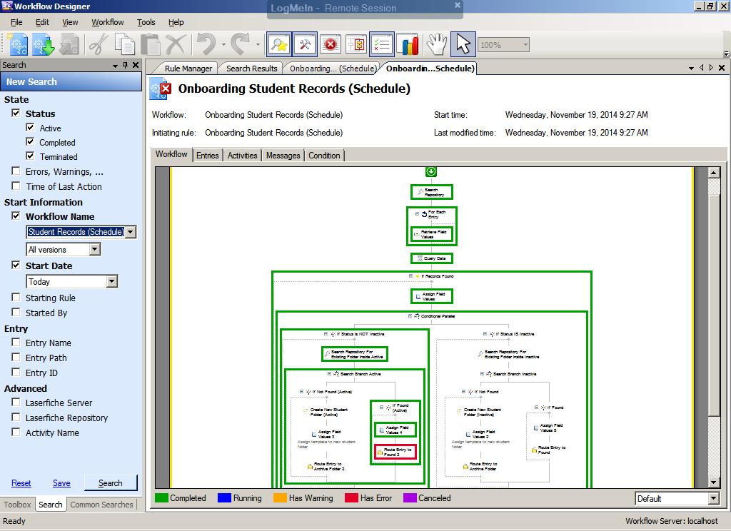

I have two workflows that do the exact same thing.  WF 1 utilizies a wait condition before moving documents.  WF 2 runs on a schedule with minor changes to the workflow to search repository to find documents that meet the criteria then move them.  I get the error on WF 2
and can not figure out why!  Any help would be appreciated.

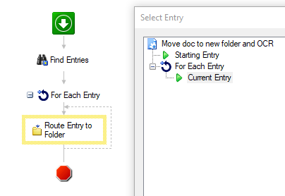

replied on January 23, 2020
Here it is almost 6 years later, and this post was very helpful to me.
I had a scheduled Workflow that would run successfully if I started it manually, but if relying on the Scheduler, the Workflow would stop when it had to route the document to a folder (which was the whole point of the Workflow).  When looking at messages for the halted Workflow I saw the following:
Entry not found. [0472-WF1]
Based on the information from Alexander Huang above, I did the following:
Changed the "Route Entry to Folder" to "For Each Entry" and "Current Entry".
That did the trick.
The Workflow is now looking for and moving documents as expected, on schedule.
Thanks to all who posted here.
It was a big help.
Christine
replied on November 19, 2014
In WF 2 here is where I get the error:
Route Entry to Found 2:
Move the Starting Entry to %(SearchRepositoryForExistingFolderinsideActive_FirstResult_FullPath)\%(RetrieveFieldValues_Document Category)
I dont think it is permissions I basically copied WF 1 and made some modifications.  It locates the folder but can not find the entry to move into the folder.  It works fine with the wait condition but bombs out with the schedule.
WF 2.jpg (121.18 KB)
replied on November 19, 2014 Show version history
I see now, the picture makes it much more clear.
Basically, when you start a scheduled task, you do not have a starting entry unless you set one specifically. This is why your workflow is erroring when you get to that part of the Workflow.
Do you plan to keep both versions of the Workflow running? If so I would recommend having your scheduled task do the search, go in to your For Each Entry loop,  and then invoke Workflow #1 if it makes sense to. This way you do not have to maintain two separate versions of the workflow that essentially do the same thing.
If they should remain separate you will most likely want to move the entire Decision tree with the Query Data task into your For Each Entry loop as I think you want to go through all that logic/tasks for every entry that returns back in the search results instead of just once. You will also want to target the output of the current Entry for all the tasks below it such as move and metadata changes.
Hopefully that makes sense.
replied on December 1, 2014
The issue has been resolved by moving the rest of the workflow  into the For this entry activity.
Thanks for all the help
