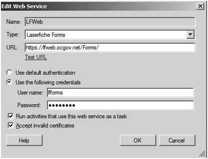

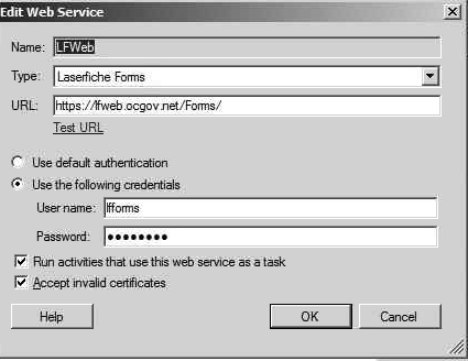

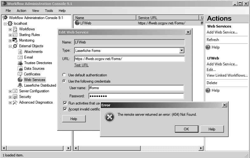

I am building a workflow where I am trying to retrieve the field values on a form.  Below is the configuration I'm using to access the form from the workflow.  The form is on a web server in the DMZ and workflow is on an internal server.
When I click the Test URL link I get "The remote server returned an error: (404) Not Found".  On that same server I copied and pasted the URL into a web browser and it brought up the Forms start page.

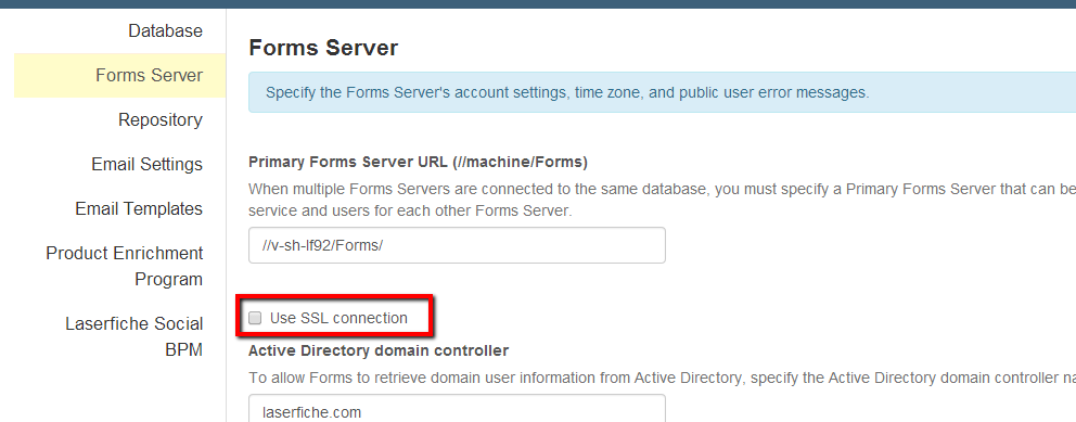

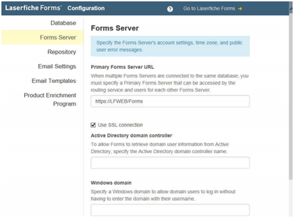

Also please check the "Use SSL connection" on Forms Server tab in Forms configuration site is checked since you are using https to access Forms.

I am experiencing the same issue on versions 10 of Workflow and Forms.  I couldn't get past the 404 error.  I tried restarting all the services and recreating the Web Service connection and  nothing worked.  I finally went onto the Forms Server configuration and changed it from HTTPS to HTTP and then back to HTTPS and it suddenly started working.   After I got it working on my development environment I tried it on my live environment which was broken too.  I verified that the following fixed it:
  • Go to https://server.domain.com/FormsConfig...Forms Server
  • Under Primary Forms Server URL uncheck "Use SSL connection" then click Save
  • recheck "Use SSL connection" then click Save
Although this process probably just triggered some sort of IIS reset and the SSL settings had nothing to do with it.  I'm concerned that this will intermittently happen and break some workflows in the future so I thought I'd attach my notes to this thread in case someone is still looking into a fix.

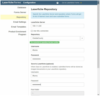

Is your Forms server configured to work with this Workflow server? (on the Forms Configuration page at the bottom of the Repository tab)

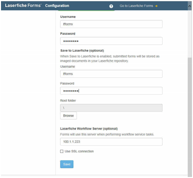

replied on October 30, 2014
I confirmed:
1. Workflow Web Service is installed and configured
2. There is a Web Service for Laserfiche forms in the Workflow Admin Console (I did notice when I test the link I get the (404) not found error.
3. I put in the workflow server IP address on the Forms Configuration Repository page.
Does this mean there's a communication problem between the 2 servers?
Thanks
Sandy
Can you double-check the Forms Configuration page and make sure the "use SSL" checkbox is not checked in the Workflow section (or that it matches what you set for the WF web service if you are using SSL for it).
replied on October 31, 2014
Here are all my settings and I still have the issue
Workflow Admin Console/Web Services
LF Forms configuration LF server (use ssl did not work)
Forms Configuration for the Workflow Server
Forms Configuration - Forms Server
