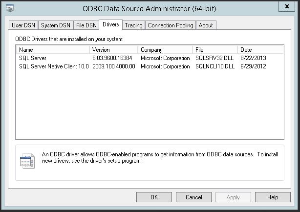

We re-installed Laserfiche Server 9.2 and made sure only one native driver was available. See attached photo.

Could you please uninstall the SQL Native clients currently installed on the machine and then install the SQL server native client 2005 that ships with LF install package?
replied on October 22, 2014
Laserfiche server 9.2 comes packaged with SQL 2008 native client...
In this case, should we still uninstall SQL 2008 native client and reinstall the 2005 version?
Can you confirm that you are using Laserfiche Administration Console 9.2.0? When you are using Laserfiche Server 9.2.0 and Laserfiche Administration Console 9.2.0, then it should be using the SQL Server 2008 R2 Native Client during repository creation/registration from the wizard.
Yeap everything is matching. We installed this server from scratch a few days ago. See attached file as proof.
