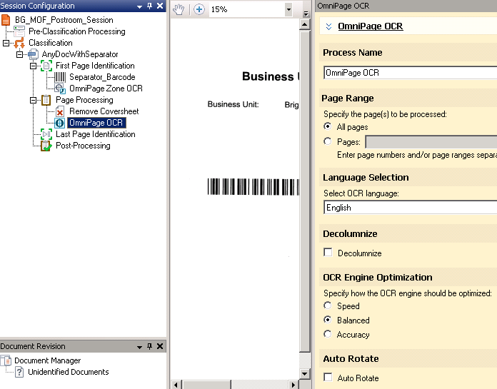

We have a quick fields session which is doing OCR'ing for all the pages scanned. (screenshot attached)
This session is scheduled to run every 1 minute (by QF Agent).
When this session runs, it nearly kills the system, where it utilizes 100% CPU (Graph.png attached).

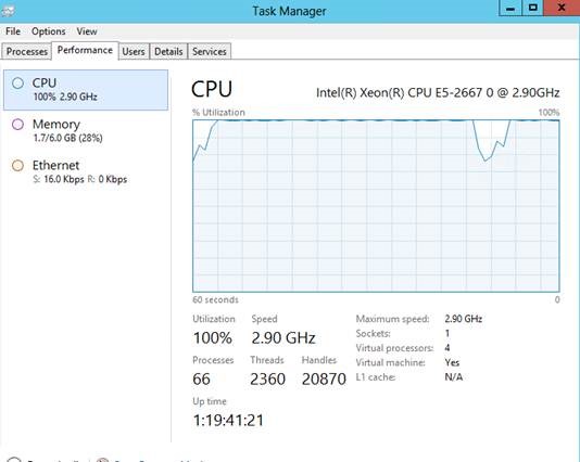

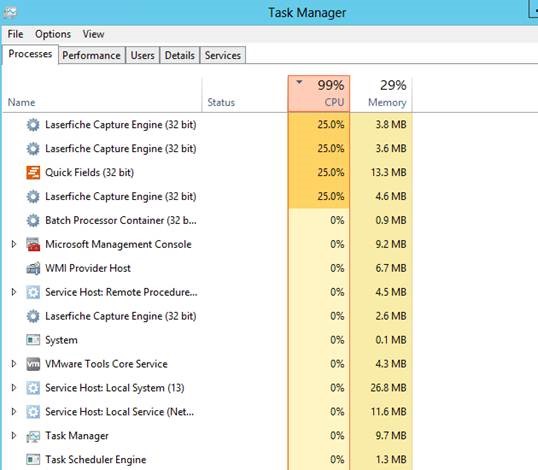

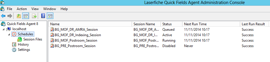

After upgrading the cores to 4 cores, CPU is still maxing out with the same 3 schedules running. Screenshots attached.
Please note: All three sessions are set-up to run after 1 minute (1 minute is a requirement).
Any ideas?
Thanks
CPU Maxing.jpg (34.32 KB)
replied on November 11, 2014
wow. how is the throughput? Did it speed up any?
Laserfiche might be able to look into this deeper to see where the slowdowns are. One thing to check for is to see where your disk i/o is at. Quickfields is very very disk intensive and if the back end of this VM is writing across an unoptimized network to disk it can be pretty slow. If the CPU Is waiting for the disk to return data it needs to process something it can peg the CPU. You may have seen this happen in the past with machines that are simply file servers if there are too many requests at once. THe CPU's get pegged waiting for the different threads that are writing/transmitting to complete.
If you have the ability I like to make a local HD on that machine the location for the install of the QF session and also where the  "save temporary documents" are placed. (this is in under tools/options/advanced).
Keep in mind that's just a shot in the dark - but I rarely see a pegging of all the CPU's like I see in your screenshot. So if I was troubleshooting that's what I'd look at next.

replied on November 12, 2014
It's not entirely clear to me from the screenshots and description if this is actually indicating a problem. Quick Fields is expected to use as many resources as needed. Is the CPU usage going back down when the session is finished?
Your screenshot is showing 3 Capture Engine processes running and you have 3 session scheduled at the same time. If the CPU is being released when the run is finished, then it's expected behavior.
