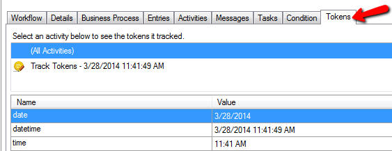

Can you include a screenshot of how the table tab is configured in the Fill Out PDF Form activity? Also, try adding a Track Token Values activity to your workflow below the activities we've discussed. This will allow you to see what value (if any) Workflow is trying to put into this table.

replied on August 4, 2014
First, publish the workflow with the track tokens activity included. Then, run the workflow. After it has run open up the instance details for that instance of the process (you can find this by searching for Recent Activity within the Workflow Designer). With the workflow instance details open you'll now see a "Tokens" tab available. In this tab you can view the values that were stored/used throughout the process.
