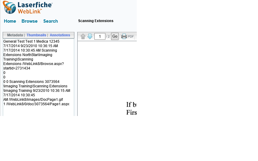

It worked just fine and the results display as intended.  The other issue we have is the metadata display is seemingly corrupt.  We have tried re-installing and it has not changed.  Here is a picture of what the general template looks like.
Not sure what to try here.  We have done the bookmarks before with never a problem and we have done the customization from the KB article at other clients too (combined with welcome) and never had problems.

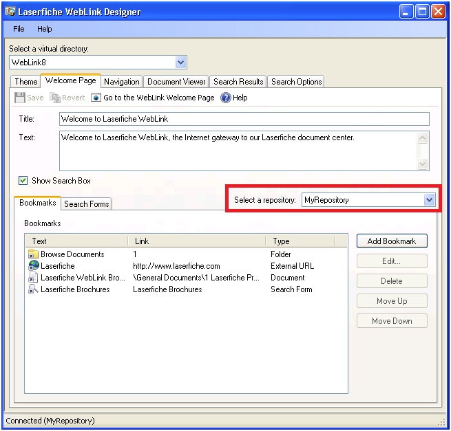

Can you also confirm that in the WebLink 8 Designer, you have the correct virtual directory selected (if you are in fact using more than one) and also that you have the correct repository selected (if multiple repositories are configured).
Then verify that when you are logging into WebLink, it is using the same virtual directory and repository specified.

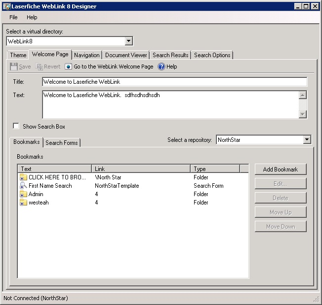

For reference here is what the deigner looks like:

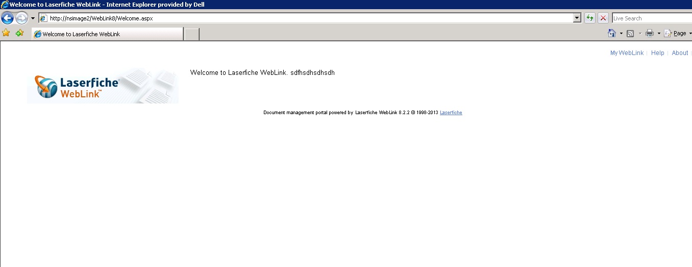

Here is what the page looks like.  As you can see there are no bookmarks or search forms..
