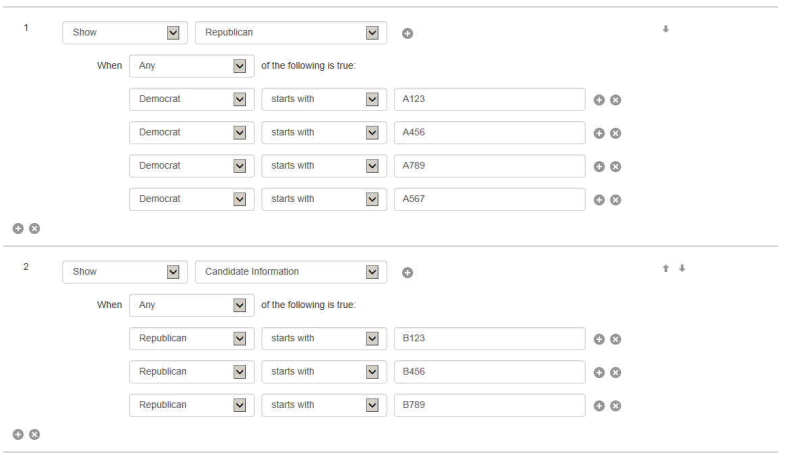

I have a form with a number of hidden fields.  The form opens to a single field and based it having the correct data this will open another field and so on.  When I open the form on the LFForms server everything works as expected.  However if I go to another server and open the form all the fields show immediately.  Did I miss a step?

What browser are you using to access the form on the Workflow server? Can you provide a screenshot of the field rules you have configured?
replied on June 18, 2014
Thanks for your help!  The browser in all instances is IE 11.  Attached are the rules.  The first field must have one of four specific values.  When one of them is typed in another field is revealed where one of three specific values has to be entered then the entire form is revealed.  I'm using this as almost a login situation.
