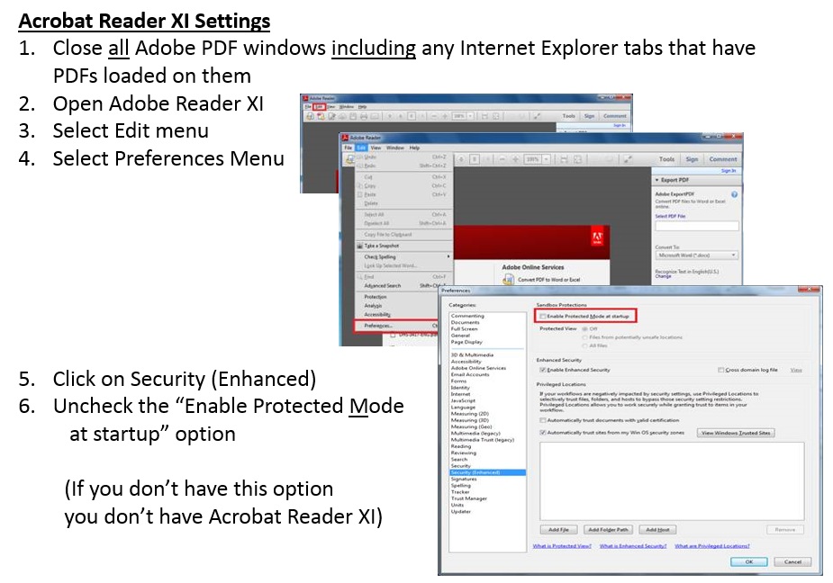

We had a similar issue to this with PDFs coming in where the text looked garbled or as if in another language.  We found that changing a setting in Adobe fixed the problem.
replied on September 3, 2015
This is a workaround we used for a while. Updating the latest version of snapshot should take care of this issue. We have not run into it since getting to 9.1.1.
