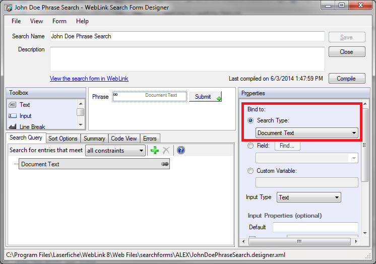

What element is your field bound to? Is it bound to the "Document Text" search type? Please open a support case so this issue can be looked into further. It'd be helpful to enable LFS tracing for only the search event class. Then recreate the issue in WebLink and provide us with the .etl file. This way we can see the exact search syntax that's being sent to the server.

replied on June 3, 2014
I was asking about the specific field being used for the phrase search. In the search form designer, you select an element to bind the field to. I would like to get confirmation if you're using "Document Text" or some other search type. See below for reference
No, it is set to "Any Text".  I am in performance monitor on the LF server and am unsure of which trace to enable.  I see one for Laserfiche Full-Text Index and Search Engine Trace.  Is that correct?

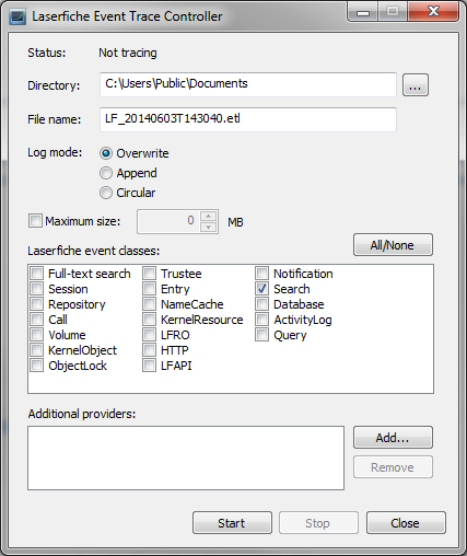

Go into C:\Program Files\Laserfiche\Server and run LFTraceCtl.exe. Then start a trace with only the "Search" event class. See below
Once the trace has started, run the search in WebLink. After the search completes, stop the trace and provide the .etl file to Laserfiche Support for review.
