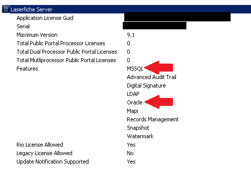

Does the Laserfiche Rio Oracle license allow a customer to register repositories with a mix of both Oracle and SQL databases?  A customer is looking to transition from Oracle to SQL and I would like to know if they can use the same Laserfiche server to host repositories with both kinds of databases.

The Laserfiche licensing and backend structures for Oracle and SQL are different, so you won't be able to use a Rio Oracle license with a mix of Oracle- and SQL-backed repositories.
What time frame is the customer looking at for their transition from Oracle to SQL databases? Your Laserfiche Regional Manager can provide you with a temporary Laserfiche Rio SQL license for use during this migration. This would allow you to have both your Oracle and SQL servers set up for a short period of time, with repositories on each, as you make the migration from one system to the other.

Hi Kelsey, thanks for the response.  I had assumed this as well, however upon reviewing their feature summary in the License Manager, it indicates that both SQL and Oracle are supported.  I've attached a screenshot for you to look at. Would this not indicate they have capabilities to have both SQL and Oracle-backed repositories?
As for a timeframe, the customer is looking at migrating their repositories over a period of several weeks, and then performing extensive testing on all of them. Several of the repositories are quite large with a multitude of workflows to test through on each, and they want to be certain the conversion is 100% successful before pulling out the rug, therefore it may involve two-three months of full conversion tasks and testing.
