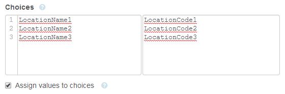

 I have a Forms Drop-down populating from a Lookup Rule.  The Lookup Rule is using a stored procedure that returns LocationName and LocationCode.  A drop-down has the option to "Assign values to choices", but I don't see how this is done from the Lookup Rule.  I'd like the Drop-down to use LocationName for the display, but store LocationCode.   It seems as though I can only choose one field.

The Assign values to choices checkbox allows you to specify different values for each selection, but does not take variables and cannot be used with lookup rules. Could you split this into several rules?
1) Fill a drop-down with the location names.
2) When a location is selected, fill another field with the appropriate location code.
