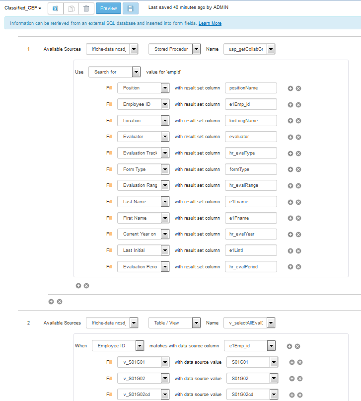

postpone java execution until a field is populated following a view lookup.
asked on October 10, 2014
I have the following JavaScript to fill in some radio buttons using single line fields that are populated with data following a lookup of a stored procedure.  I need to postpone the execution of the functions using case statements until after the view has populated the single line fields.  Can someone Help?

replied on October 11, 2014
I have solved this problem by rewriting your recommendation for "How to fill checkboxes from a database"  please see the comments on that question for a solution to delaying the trigger of the view.
replied on August 15, 2016
I know this is an older question, but I had the same issue with a very complex form and I believe I found an elegant solution. If you have code that you want to run once after a lookup populates a field, either at the beginning or later on based on another action, jQuery has a very handy "ajaxStop" action.
//If after page loads, then this will be in $(document).ready(function(){...
//otherwise, this can be used in any other method or click/change event handler.
$(document).one('ajaxStop',function(){
  //Execute your run-once code here
This will attach an event that will only run once, that will be run once ajax has completed, which is when the lookup on a field has completed.
replied on October 10, 2014
you will need to include a timeout statement in there to delay it. I find that for lookup most lookups happen in a half second to a full second. If there is no values in a field you can use a timeout to test a field and retest every so often until you know its filled and then proceed.
