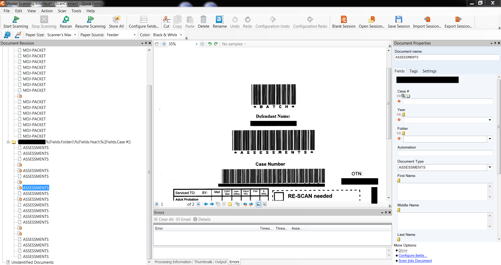

We have a client that we have been working with for quite a long time that has been seeing an alarming high rate of barcode misreads on their scanning stations.  They currently scan thousands of documents a day and each and every one of them is separated by what we refer to as a "Batch Header Sheet". You will find a few samples attached to this post as "fig1 Redacted.pdf".  During the scan process into Quick Fields it is checked against 6 document classifications, once classified, it runs a process on the Batch Header sheet to pull information from up to three more barcodes, uses that information to perform a Realtime look-up against a SQL database to fill more indexing information, which is then used to sort and name the document.

replied on March 21, 2014
Example of barcode misread

If you look closely at the barcode you will see there are some issues with the image. The way barcodes work is it calculates the lines and breaks and turns that into data. If the scan causes inadvertent breaks or connects unconnected lines, the barcode will not be read correctly.
Sometimes the image enhancement "smooth" can help (be sure to grow and shrink by the same amount to keep from permanently affecting the lines), but the issue here is in the scan quality.
