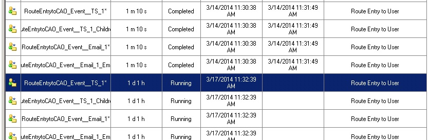

Ok, so upon further examination, I have instances that are both sitting waiting for user to change approval field.  Some show running, while others show waiting.  Those with status of Running show several activities running for days; while those with status of Waiting show similar activities completed within seconds or milliseconds.
I have been having a problem with some workflows meeting wait conditions but 'stalling' and not moving on to subsequent activities.  I'm wondering if this is related.
Cap of Activities tab for instance with status: Running
And one with status:  Waiting
I have an email that repeats every day for 90 days until the wait condition is met.  it looks like WF might be hanging on those activities.  Do you think that is the case?

replied on March 18, 2014
Waiting indicates that the workflow is waiting for some external action to happen. It could be that it is waiting for a timer, condition, or one of the out of workflow 'tasks' to finish (like a script).
Running indicates that the workflow is actively doing some work at this moment and is taking up one of the concurrent queue spots for that definition (which typically is 4 per logical CPU of the server machine).
All activities can be in the running state fleetingly.
