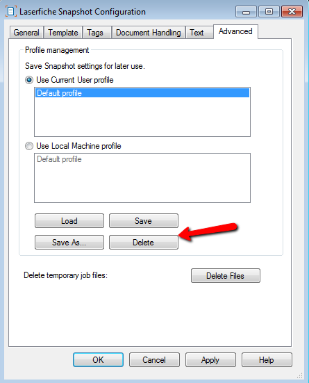

That's odd, I don't think I've run into that issue before with 9.1. I'll definitely check it out to see if there's something that needs to be addressed there. Meanwhile you can open up the Laserfiche Snapshot Configuration and go to the Advanced tab. You should be able to delete existing profiles from there. I've attached a photo to help clarify.

Thank you for the replies. I tried to delete the profiles from the snapshot configuration and I was unable to delete the default profile. I tried editing the default profile and I tried adding a new profile and it seemed like the settings would not "stick" and that they did not resolve the issue. Also I tried logging into the repository through the snapshot configuration as a different windows user to see if it was a permissions issue but the login failed every time. (not an issue just thought it could be helpful for trouble shooting. It seems like we are only able to print using the LF snapshot printer if there was never a profile set up. I was hoping the profiles were stored in a file in the users appdata folder and could be easily deleted.
