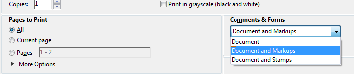

replied on December 9, 2013
Thank you all for the help.  Found that in Adobe Reader Markups had been turned off.
Hi Bryan-
Including PDF markups in the printing should be a function of Acrobat Reader or whatever PDF application you are using. On the Laserfiche side, you might find better luck with the native PDF page extraction, which does have the option of preserving PDF annotations. In general, we recommend using this method over Snapshot.
