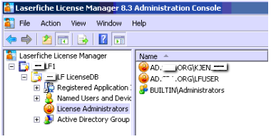

replied on November 13, 2013
Hi, yes I did follow the instructions on adding a License Administrator, I've provided an image.  My users have the License Manager Admin Console installed on there machines and can view everything but when they attemp to add a named user or license a devise they receive a message telling them permissions denied.
