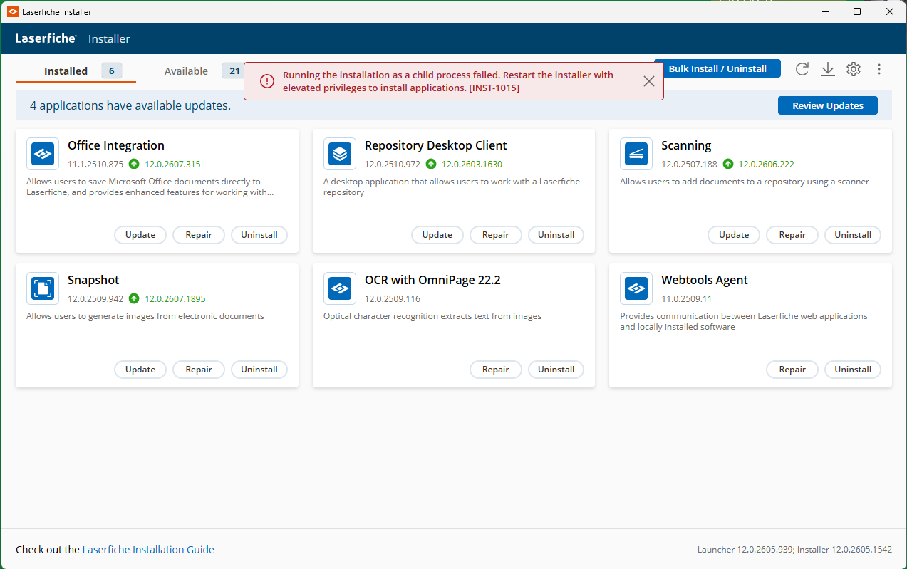

When the LF Installer is started without Elevated permissions, it prompts to restart with elevated privileges.

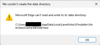

If they start the installer with "Run As Administrator", then it tries to write its data to the AppData of the user whose credentials where provided instead of to the current users AppData and the current user does not have permissions to another users AppData location so it errors out as well.
How are we supposed to install the software without logging into the local machine with an administrative user?
