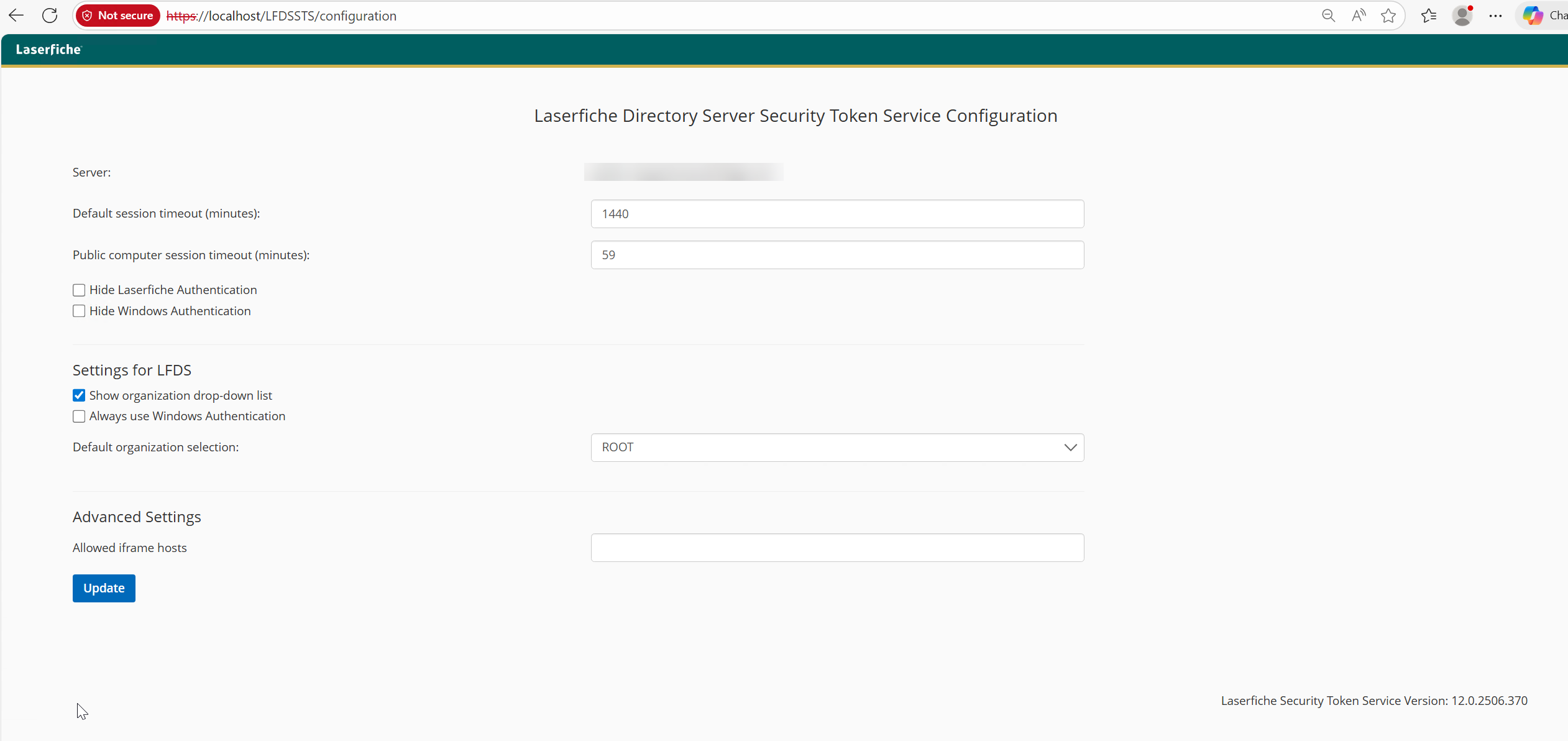

replied on January 23
I don't seem to have that option.
Ah, you're running an older version where you have to set it in a config file because it's not exposed in the LFDSSTS Configuration UI yet. Here are the instructions for LFDS 11: Configuring a Redirect Allowlist
