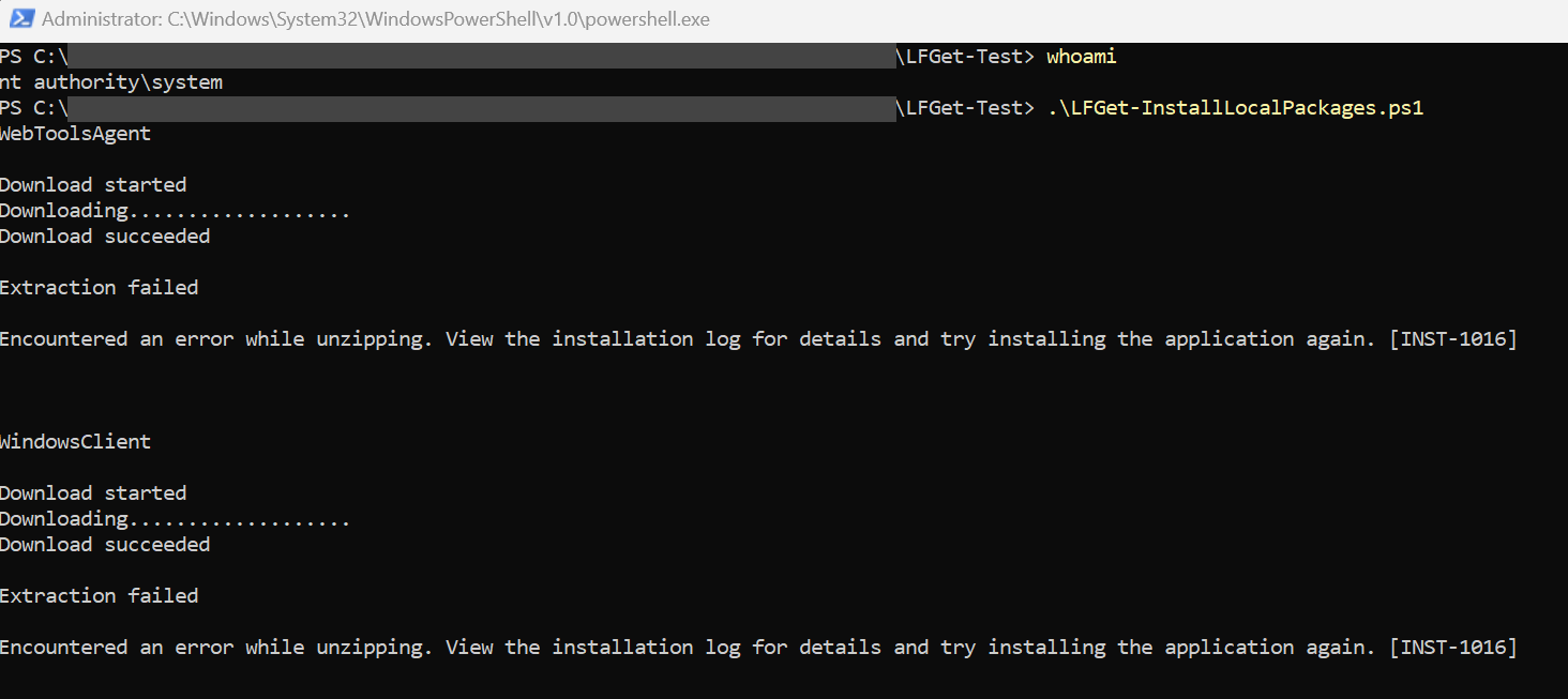

We still don't expect the command to succeed running as SYSTEM right now with LFGet version 12.0.2510.1223, but you should get the handled exception from LFGet shown below instead of a System.IO.IOException:
  • Encountered an error while unzipping. View the installation log for details and try installing the application again. [INST-1016]
