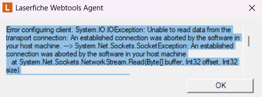

I’m currently facing an urgent issue related to the latest version of Laserfiche 12, specifically with the Laserfiche Web Agent.
I’ve downloaded and installed the Web Agent in order to use the Scanner feature for archiving. However, whenever I try to click on the Scanner icon from the Laserfiche Web Client, I am prompted to download the Web Agent again—even though it’s already installed.
I’ve tested this on both Chrome and Edge browsers.
To troubleshoot, I’ve removed all archiving-related applications from my device and reinstalled them, but the issue persists. When I attempt to use the scanning feature, I receive the following error message:
 Error configuring client. System.IO.IOException: Unable to read data from the transport connection: An established connection was aborted by the software in your host machine. ---> System.Net.Sockets.SocketException: An established connection was aborted by the software in your host machine
   at System.Net.Sockets.NetworkStream.Read(Byte[] buffer, Int32 offset, Int32 size)
   --- End of inner exception stack trace ---
   at System.Net.FixedSizeReader.ReadPacket(Byte[] buffer, Int32 offset, Int32 count)
   at System.Net.Security.SslState.StartReceiveBlob(Byte[] buffer, AsyncProtocolRequest asyncRequest)
   at System.Net.Security.SslState.CheckCompletionBeforeNextReceive(ProtocolToken message, AsyncProtocolRequest asyncRequest)
   at System.Net.Security.SslState.ProcessReceivedBlob(Byte[] buffer, Int32 count, AsyncProtocolRequest asyncRequest)
   at System.Net.Security.SslState.ForceAuthentication(Boolean receiveFirst, Byte[] buffer, AsyncProtocolRequest asyncRequest, Boolean renegotiation)
   at System.Net.Security.SslState.ProcessAuthentication(LazyAsyncResult lazyResult)
   at uhttpsharp.Clients.ClientSslDecorator..ctor(IClient child, X509Certificate certificate)
   at uhttpsharp.Listeners.ListenerSslDecorator.<GetClient>d__3.MoveNext()
--- End of stack trace from previous location where exception was thrown ---
   at System.Runtime.ExceptionServices.ExceptionDispatchInfo.Throw()
   at uhttpsharp.HttpServer.<Listen>d__9.MoveNext()
System.Net.Sockets.SocketException (0x80004005): An established connection was aborted by the software in your host machine
Please see the attached files for more details
I would appreciate your urgent support, as I’m planning to launch the new system very soon.
Note: I am using Laserfiche Self-Hosted.
Thank you.

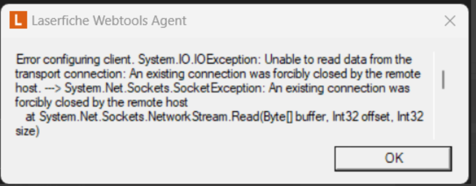

Hi everybody,
Has there been a consensus about what causes this issue?
We started seeing it pop up on individual workstations after upgrading those workstations to LF12.
We have fully upgraded our on prem environment as well to LF 12.
Any ideas are appreciated. :)
Not sure what to do about the pop up.

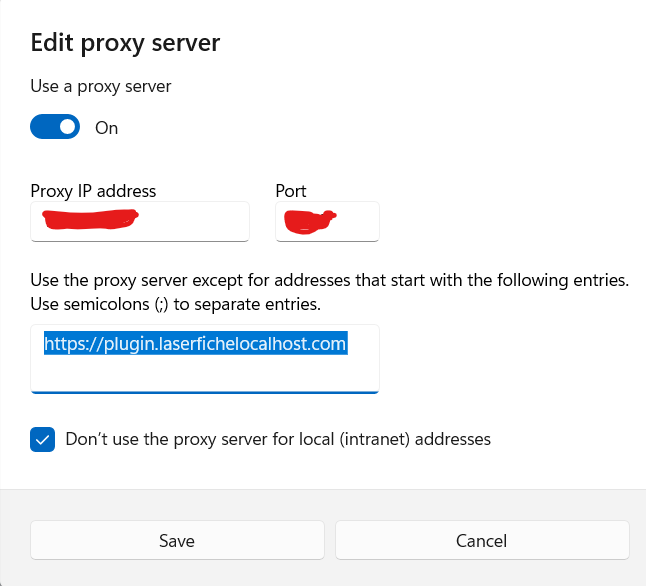

HI,
I experienced the same issue and was able to resolve it successfully. I recommend trying the following steps to address it:
  1. Check if a proxy is enabled on your system.
    If so, make sure to add the following URL to the Exception box:
    https://plugin.laserfichelocalhost.com
  2. Download and install the certificate for the archiving system on your local machine.
  3.
