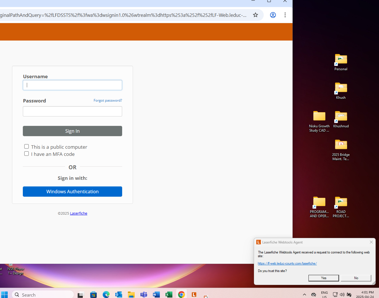

Currently, there will be a security pop-up (see below, in the bottom-right) that comes up after the install is complete and the connection between Office and the Web Client is established by doing a Save to Laserfiche and adding the repository in Office - and if the pop-up action is not approved quickly enough, the pop-up disappears and blocks the Web Client from connecting to the Office integration. After this happens, the user then cannot open files from the Web client in Office on their desktop (they will endlessly be prompted to download the Office plugin and install it, despite it being installed on their machine).
I haven't been able to figure out where the dismissal is actually registered in Windows (so that I could potentially instruct users on how to approve the security request after the fact), so the only solution I have is to uninstall everything and then reinstall it myself manually so that I can catch the pop-up when it comes up, which defeats the whole point of the MSIs and GPO install procedure.

Hi Hannah,
With respect to the "Do you trust this site?" pop-up from Webtools Agent:
Webtools Agent throws the pop-up prompt when you try to connect it to a site that isn't in a Trusted Hosts list is stored in the Windows registry. All the prompt does (when approved) is add the site to the Trusted Hosts list so it doesn't appear in the future.
You can easily push the registry value(s) out to end users via GPO or other automated means.

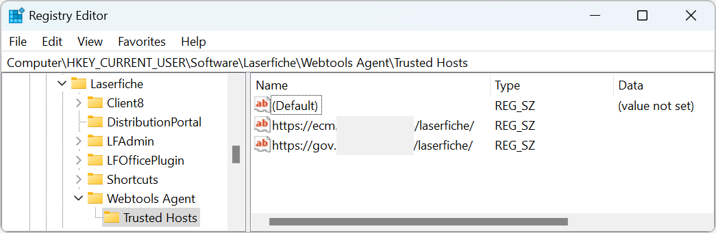

As shown in the screenshot below, the keys (type REG_SZ) with the trusted Repository Web Client sites/URLs go under:
Computer\HKEY_CURRENT_USER\Software\Laserfiche\Webtools Agent\Trusted Hosts
