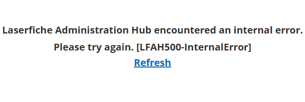

Unfortunately, the Administration Hub keeps giving me an error.
I couldn't find any logs under the Event Viewer as they were on Laserfiche 11 (which I guess makes sense if they are supposed to be centralized here to the Hub), but other post mentioned a log in ProgramData.  This post: https://answers.laserfiche.com/questions/228118/Administration-Hub-Diagram-Error-LFAH500  This log file: C:\ProgramData\Laserfiche\AdminHub\Logs\AdminHubLog_w3wp.log
In that file, the most recent entry says the following:
2025-05-03 09:54:32.4694||ERROR|AdminHubLogs|36|--- 2025-05-03T15:54:32.4604571Z AHWebContext started.

The screenshot with [LFAH500-InternalError] indicates that you already login as administrator. But from the error log, http status is Unauthorized, which means Administration Hub api calls losing the authentication as administrator.
This could be Administration Hub configuration issue. Could you try using Laserfiche.AdminHub.AdminHubUtility.exe(under C:\Program Files\Laserfiche\AdminHub\AgentController) to reconfigure Administration Hub?

What we ultimately found is a long-standing issue that I've been fighting with for years.
We don't currently have an internal certificate authority.  We have been using certificates purchased from an online provider (GoDaddy) for both our Laserfiche server and our Forms server, with addresses like lf.website.com and lfforms.website.com.  This has worked well for years with our staff connecting to those sites via browser.  But it causes some problems with the back-end of things, where the system is not wanting to use those designated addresses, but defaulting over to the machine.domain.local FQDN instead of lf.website.com  FQDN that we have set-up.
Even though we've told the Admin Hub to use lf.website.com, it seems it actually wants to use machine.domain.local.  Once we switched the configuration (C:\Program Files\Laserfiche\AdminHub\AgentController\Laserfiche.AdminHub.AdminHubUtility.exe) to using a self-signed certificate for machine.domain.local - it worked without the errors.
I've had similar problems for years trying to get STS working through LFDS, and have come up against this problem.  The advice I received years ago is that we need an internal certificate authority set-up that can generate a single certificate that includes SANs (Subject Alternate Names) so that the same certificate works for lf.website.com and machine.domain.local and localhost.
Unfortunately, I've been pushing management for years to get that internal certificate authority set-up, and it still hasn't been done.  So I'm kind of stuck right now.
