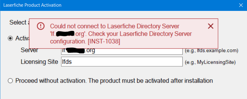

I've upgraded LFDS to LF12 (12.0.2503.265) and everything appears to be functioning correctly, so I was trying to install one or two other things.  But I'm getting an error in the installer when trying to configure it to do licensing from LFDS.
I guess it's not completely clear what it is expecting here.  I'm listing the URL that we have set-up for that server and the website that LFDS set-up.  I can browse to LFDS using these values as the address, but it doesn't like it here.
The error message says to check my LFDS configuration, but it isn't clear what part of the configuration it is referring to.
The help documentation for the installer also doesn't include much helpful information regarding what is expected here.

replied on May 5
Yeah, "Proceed without activation" was what I ended up doing in order to get anything installed.
When on the same machine that LFDS is installed, I can't browse to LFDS with the FQDN, only with localhost, but the installer doesn't work with localhost either.
On a second server, I can connect using the FQDN, but the installer still doesn't like it there.

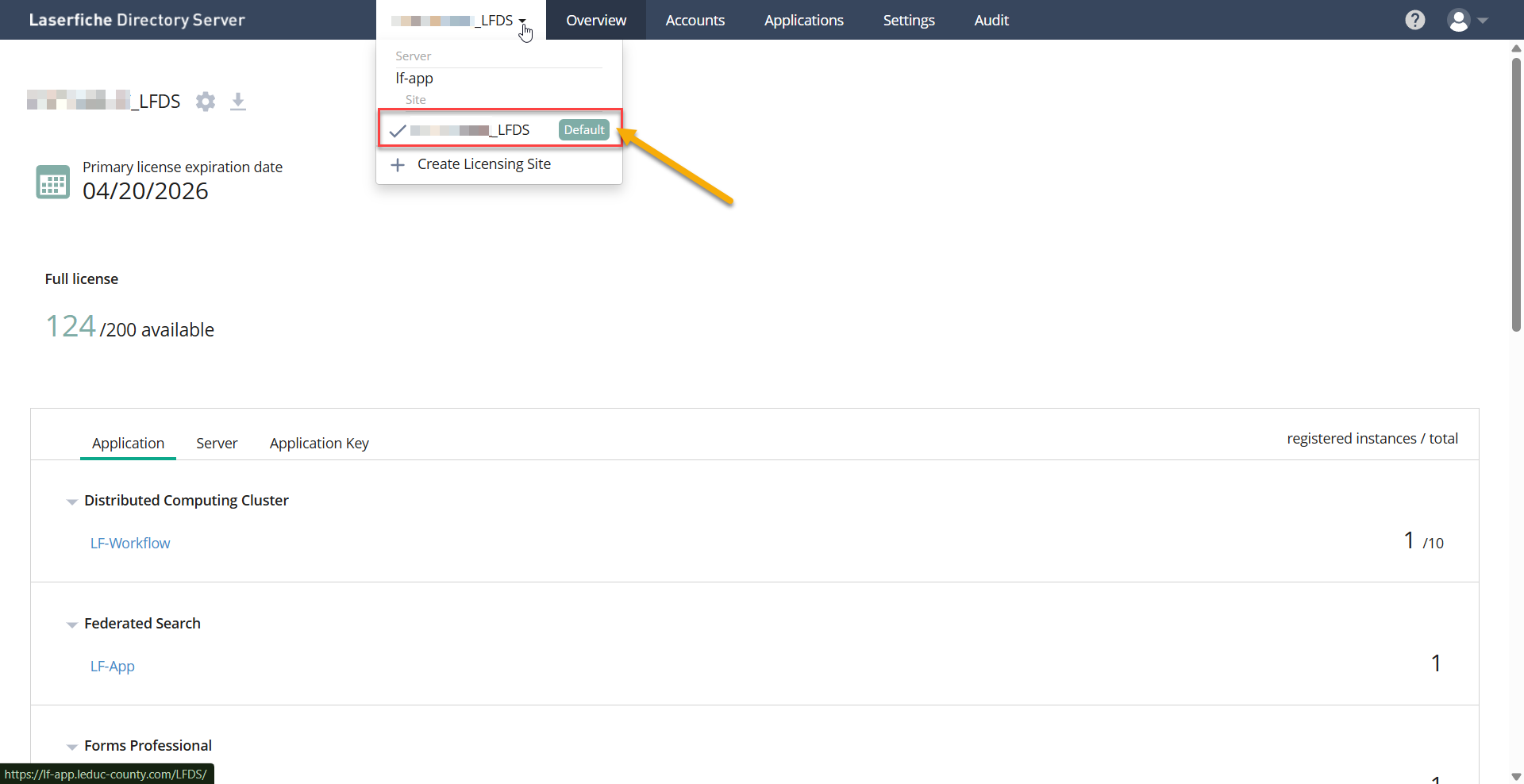

replied on May 5 Show version history
Hey Matthew!
I'm not sure if this is the answer or not, but I suspect the name of your licensing server might be entered incorrectly in the field you screenshotted - this is what ours looks like:
Is the value you're putting in the one that you see from the dropdown in LFDS (I put a box around our value)? that's what you'd want to be putting in the "Licensing Site Name" field, if I recall correctly.
replied on May 5
No, that part for mine just says LFDS.
The server listed there is the machine name, not the URL we have set-up for it, which doesn't surprise me, but even trying to use that instead of the URL doesn't work (I tried machine, domain\machine, and machine.domain.local with no success either).
I'm going to open a ticket with our solution provider.
