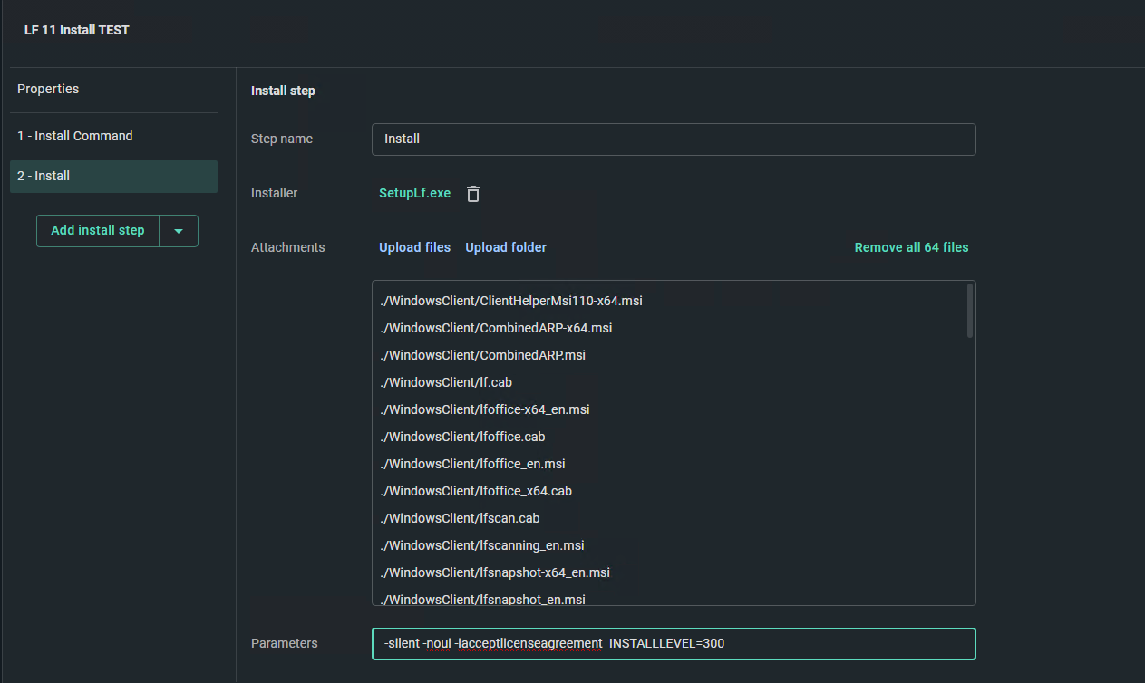

Hi - so I am trying to install LF 11 on a machine  using PDQ Connect and having some issues. I just was curious if anyone on here has used PDQ Connect and could give some advice on what I am doing wrong ?
Also  - for machines that are on a version 10 - what would be the correct way to push an install of 11 since the old version needs to be fully uninstalled.

2024-10-27 12:05:29.977 Running command: Try { Set-Location C:\ProgramData\PDQ\PDQConnectAgent\Downloads\dvc_task_8134864e2a3449f9a58\pkgstep_d58e1df9157d4e61be3 .\'EmbeddedScript011650.bat' } Catch { Throw $_.Exception.ErrorRecord } If ($LASTEXITCODE -ne $null) { exit $LASTEXITCODE } If ($PSVersionTable.PSVersion.Major -lt 3) { If ($Error.count -gt 0) { exit 37105 } } If ($Error.WriteErrorStream) { exit -37104 }
2024-10-27 12:05:30.614 Step 'Install Command' failed, error mode is set to StopAsError
Errors
C:\ProgramData\PDQ\PDQConnectAgent\Downloads\dvc_task_8134864e2a3449f9a58\pkgstep_d58e1df9157d4e61be3>WindowsClient\SetupLf.exe -silent -lang en -iacceptlicenseagreement INSTALLLEVEL=300 LFSSADDLOCAL=ALL
The system cannot find the path specified.
Failed to run task 'dvc_task_8134864e2a3449f9a58'
replied on October 28, 2024
Run setupLF.exe with the -log flag as well so we get more information on what it can't find. Though, it's likely it's the contents of the Support folder as it tries to confirm that pre-requisite components are installed.
replied on June 24
Just going to post in case anyone else has issues.  For me, I needed to upload various dependency folders (OCR, Workflow, etc. in addition to WindowsClient).  But the installer itself lives in WindowsClient.  PDQ Connect has you upload the setup file, but when you upload it, it will run it from one level up, and essentially was not running it from the WindowsClient subfolder like it needed to.
The solution was to the Powershell option in PDQ Connect so that I could point to the SetupLF.exe within WindowsClient.  You still need to upload the correct folders.
