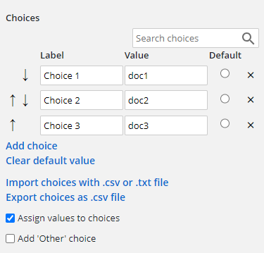

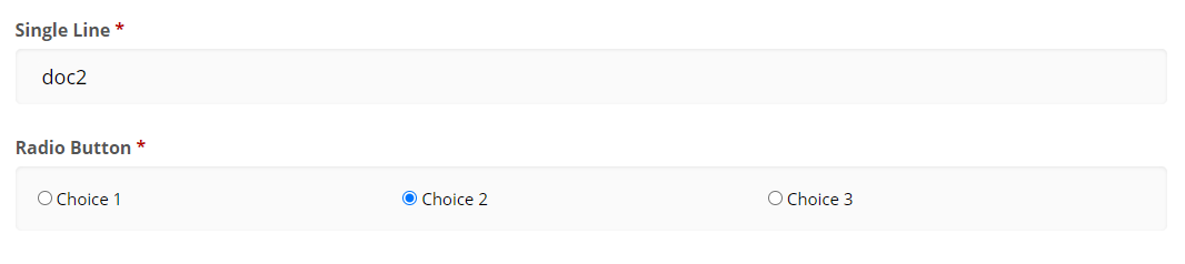

Hey Thomas, I don't think JS is necessary here. You can assign a value to a radio button, then use a regular expression to pull the value into a single line field.
Here's the RB field (variable as 'Radio_Button):

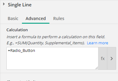

In the single line field, you just use the expression '=Radio_Button'
Selecting a radio button option will produce whatever is in the 'value assigned' of the radio button selected

I agree with Andrew that you just need a simple formula to get value from the radio button, Andrew shared a sample with the new form, I've also tested on classic form, it is working too.
