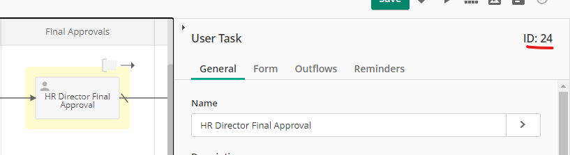

It appears that using {/_current_step_id} as a default field value does not reflect the actual step ID for a given task (step). I need to be able to count on the correct value to use in field rules. Has anyone developed a solution for this? Or am I using an incorrect system variable?
Form reports the following ID for the task which has an ID of 24

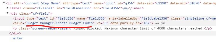

Unless I misunderstand, the current_step_ID should change to reflect the current task and indicate so each time a subsequent task is opened. Based on this, I intend to show/hiding collections and also to use the value in javascript to disable fields filled in previous tasks (to prevent changes). I have found that the current_task_name has the same problem. It still holds the next previous tasks name/ID. Actual Task name is 'HR Director Final Approval. The value attribute of the field still has the previous task name.

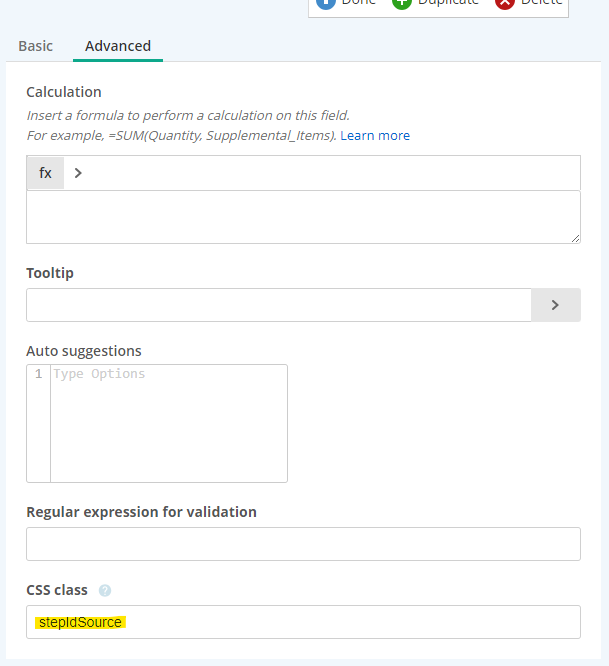

Another way to handle this would be to use a hidden "helper" field.

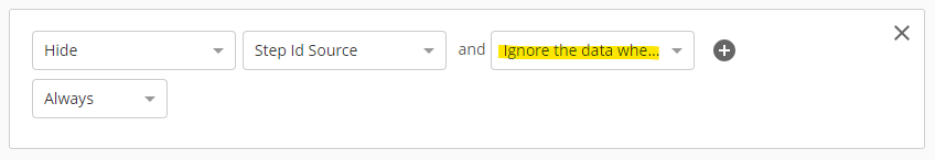

Instead of using the default directly in the display field, add a new field with the step values as the defaults. Then, add field rules to Hide Always and Ignore the value so it doesn't get saved.

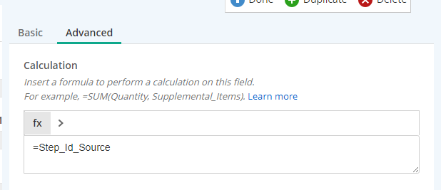

Next, instead of using the default, use a calculation to set the display field equal to the hidden source field.
Because the hidden field is ignored, it will update to the correct step id on the next task, so at that point all you need to do is trigger the calculation to run.
Adding CSS class to source field for easy identification
Calculation on display field
Field rule for source field
Quick-and-dirty javascript example to trigger the calculation to refresh based on the configuration above.
$(document).ready(function(){
    // trigger calculation after form load
    setTimeout(function (){
      $('.stepIdSource input').change();
    }, 100);

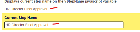

Here's the jquery from a 'solution' trying to use the step name posted some years ago...
$('.vCurrentStepName input').val('')
  var step = $('.vStepName').text();
  $('.vCurrentStepName input').val(step);
Custom HTML field...
<p><span style="font-weight: 700; color: rgb(85, 85, 85);">Displays current step name on the vStepName javascript variable</span><br></p>
<div class="vStepName">{/_current_step_name}</div>
<div class="vStageName"></div>
