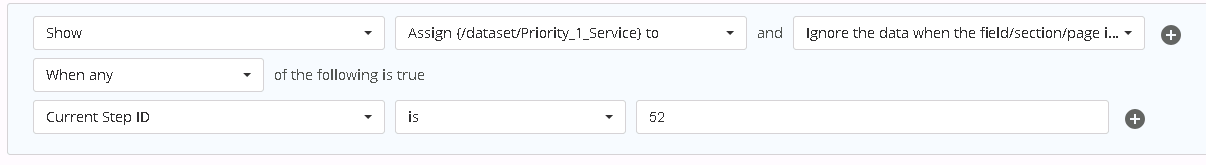

However, when I create Field Rules based on the value of that field they do not work correctly. As an example, I have a User Task that has an ID of 50 and another that has an ID of 52. The User Task with an ID of 50 is assigned first after the form is submitted. The User Task with an ID of 52 is assigned after 50 is completed. I have a Field Rule setup as follows:
For some reason, even though on the form itself it is showing the Current Step ID field (#q222) as having a value of 52 when it gets to the second User Task, the field rules are not reading it correctly. If I switch the 52 in the Field Rule to 50 it shows the field in question.

maybe try adding .change() to the code? the Field rules might trigger based on the change.
$('#q222 input').val(newStepID).change();
replied on December 28, 2018
That was it. Thank you Chris!
