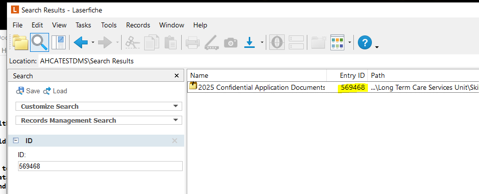

is this dll library  ( Interop.LFSO80Lib / version: 8.0.0.0 / Runtime Version: v2.0.50727 )compatible for Laserfcihe Version 11.  Trying to access the database to retrieve an entry Id is not bringing back the Entry Id via the LFDatabase.GetEntryByID(toc.parentid) method.

It does not give an error.  If connects to the server, the repository, the database.  It says the entry is not found but it is in the database table and when we search the repository it is in the client also.  Could this be a permissions issue on the table with the account being used?
