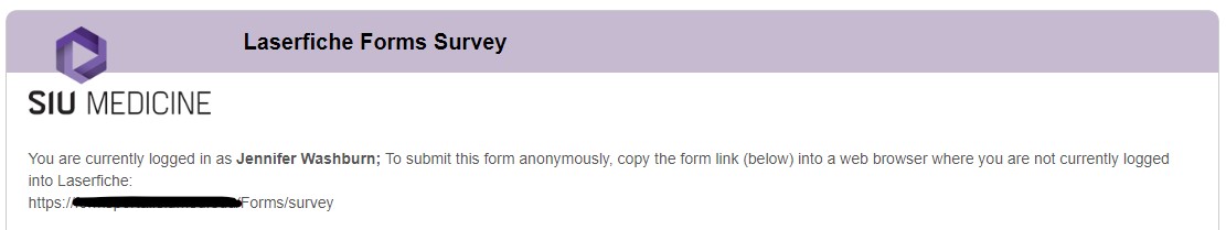

Just to piggyback off of what Zach suggested, here's how we handle this on our survey form (see screenshot).
replied on May 28, 2024
Yeah I thought about this solution. It'd be ideal for us if everyone was as technology adept as we'd like, at this company. Unfortunately asking them to manually log out and even choose which browser would be difficult for some and require constant assistance.
Might actually end up being the go, though. Thank you for your suggestion!

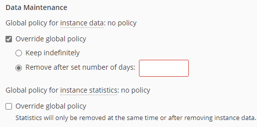

Is there a reason you're deleting data from the SQL database directly? I can't remember when the process-specific policies were added, but you can override global data retention policies and delete the instance data automatically.
Could that be used instantly after the form has finished? The way the current survey we have set up in there works is that it has a time period it remains active before being terminated. It's sent out from a request form to employees to fill out, and to ensure total anonymity and to comply with out data policies, it's just deleted straight out of the SQL server. It was the method recommended by our reseller so that it's impossible to trace a response back to any individual.
It is not instant; in Forms admin you set a start/end time for scheduled internal data maintenance. When this runs, it finds completed instances and deletes eligible data according to the global or process-specific policies.
Data Maintenance Policies | Laserfiche Forms
Although I understand wanting data removed as soon as possible, one of the reasons direct changes to databases are discouraged is they are outside the context of the application and could potentially conflict with these types of internal processes, especially as functionality evolves with new versions.

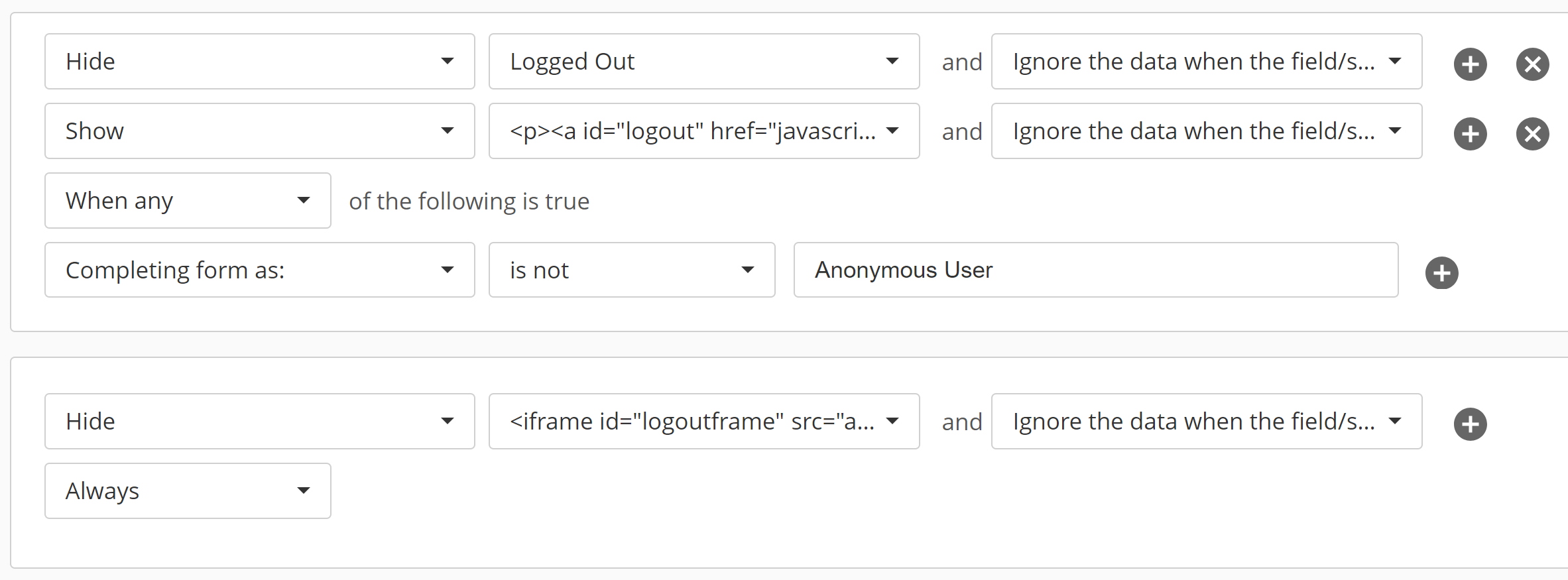

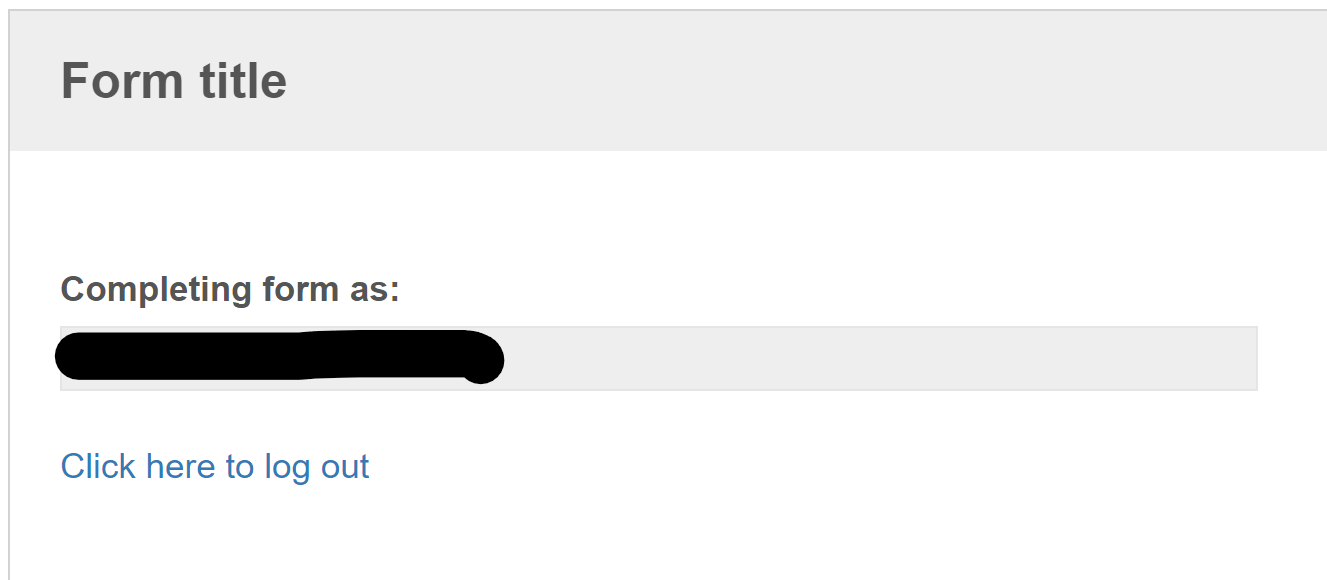

replied on May 28, 2024 Show version history

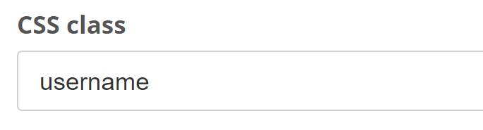

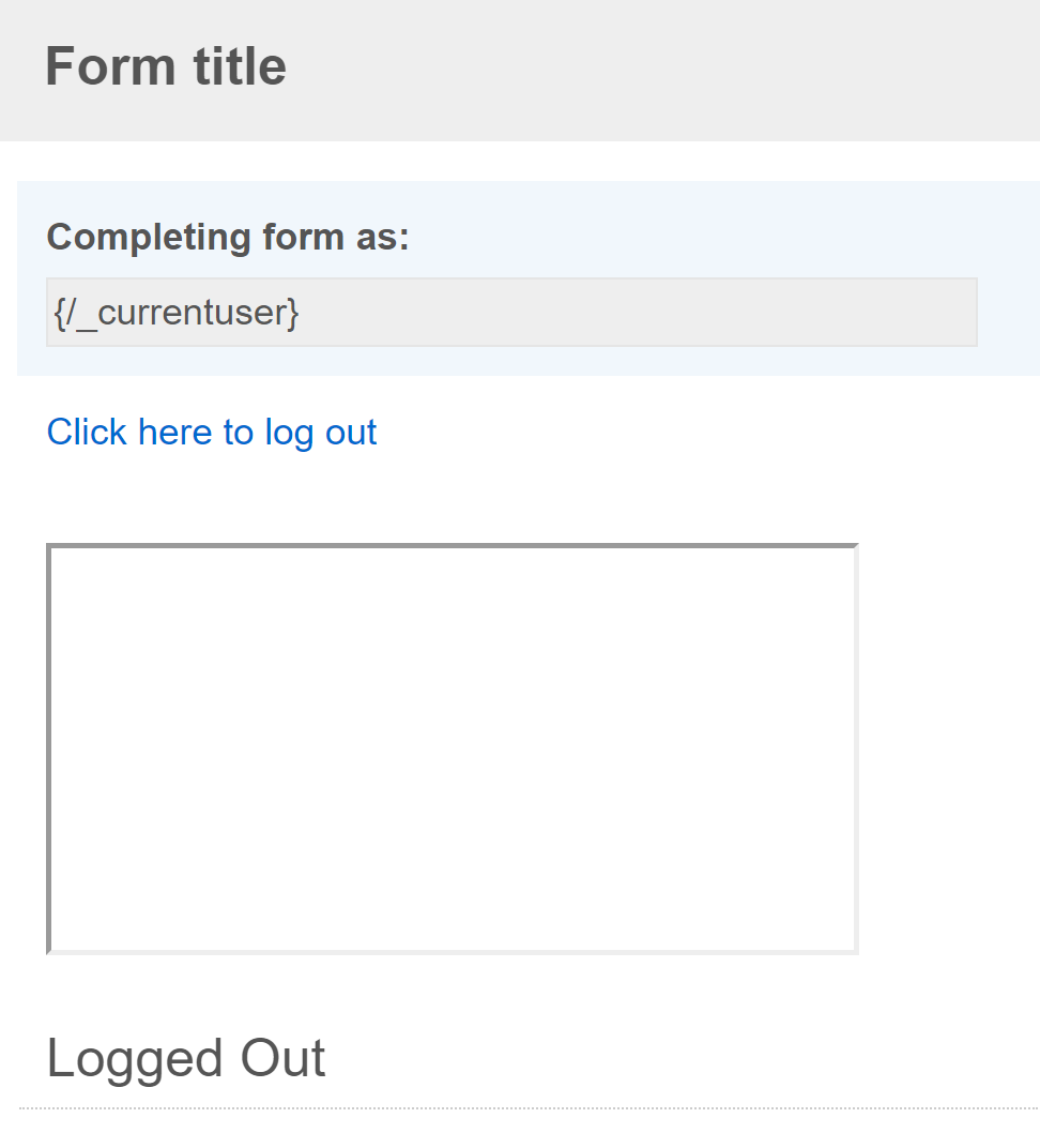

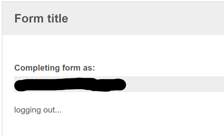

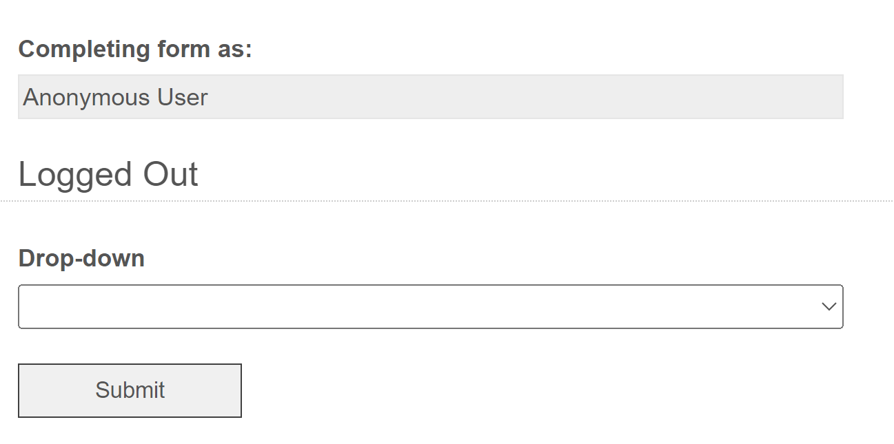

I kind of threw this together just to see if it would work, and this code would only work in the classic designer, so your mileage may vary but I tried using an iframe in a custom html element.
  • read-only field, with class "username" and default of current user
  • custom html element with a clickable link to be used with javascript
  • custom html with an iframe
  • a section to contain the actual form content
In the field rules:
  • The iframe is set to always hidden so it is only visible in the designer
  • The logout url and form section are shown/hidden based on the content of the username field (this will vary depending on whether you use the current username, name, email, etc.)
In the JavaScript:
  • Check the value of the username field and, if not anonymous, add click event handler to load the logout url (again, the exact value you want to check for depends on what you use for the default)
    • Replace the logout url text with a message
    • Add load event handler to iframe that refreshes the page
    • Open the logout url in the iframe
Fields
Class on "Completing form as" field
Link html
<p><a id="logout" href="javascript:void(0)">Click here to log out</a></p>
iframe html
<iframe id="logoutframe" src="about:blank"></iframe>
Field Rules
JavaScript
  // window check is to prevent running in designer and other frames
  // affects task windows but anonymous users can't open tasks
  if (window.self === window.top && $('.username input').val() != 'Anonymous User') {
    // hide submit button
    $('.Submit').hide();
    // add event handler to link
    $('#logout').on('click', function () {
      // set message
      $(this).replaceWith('logging out...');
      // set callback for iframe loading
      $('#logoutframe').on('load', function () {
        location.reload();
      // open logout url in frame (replace with your value)
      $('#logoutframe').prop('src', logoutUrl);
Results
