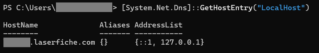

You can run that exact function in PowerShell with:
[System.Net.Dns]::GetHostEntry("LocalHost")
In a typical DMZ scenario, machine is not domain joined and has a hostname like "FormsDMZ". Which means the constructed URL is:
https://FormsDMZ/Forms/webapi/v1/WcfSettings/ValidateIISRightsForCertificate?thumbprint=ABC123
And the TLS certificate bound to port 443 for IIS likely covers whichever nice DNS alias you're using, like "publicforms.example.com", and NOT the local machine hostname "FormsDMZ".
The web request to the client certificate validation endpoint above subsequently fails to go through due to the hostname mismatch with the IIS TLS certificate and surfaces the system-level error:
