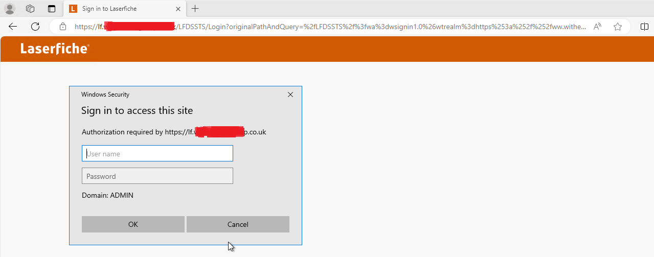

Hi,
We force SSO.  When users try and access Web Access they get a browser popup requesting user credentials. Even if user credentials are added, it sill does not allow any access. We have tried this in a few different browsers and get the same response.
We have added addresses to trusted sites in security and have the Endpoint utility using the appropriate SSL certificates (wildcard SSL) and server details. IIS has Windows Authentication Enabled and the appropriate SSL bindings are also included there too. We have recycled the LicenseManagerSTSAppPool and confirmed it is running as network service. We are a bit stumped as to where to go from here.  We have also added the address in trusted sites via GP for the browsers.
We do have a DNS A record for their domain/wildcard SSL pointing at the LFDS server IP address, but no CNAME.
We have seen this issues before (with the browser pop up when using SSO), but our fixes listed above have, at some point, fixed the issue.
Anyone have any ideas/suggestion.
Anthony

LFDS and STS are on the same server.  When the popup error is received, there are no errors listed on the LFDSSTS server or the Web Server.
As you can see from the screenshot, the user is getting to the LFDSSTS site.
The the Laserfiche Directory Server Windows Service (a) on the same machine as LFDSSTS, and (b) also running as Network Service?
LFDS is on the same server as LFDSTS.  LFDS service is running as Laserfiche Admin AD credentials (which is our standard roll out for clients).  The LicenseManagerSTSAppPool in IIS is running as NetworkService which is the required setup suggested from Laserfiche.  This is also our usual setup for clients which we do not usual change (other clients do not have this issue).
Our Wildcard SSL is installed on the LFDS server and the Web Server.  Both IIS servers have port 443 bound to this SSL certificate with their domain https://lf.domain.co.uk.  This domain is setup in DNS to point to the LFDS server IP address as an A Name record.
Could the fact that we are using this domain address (with wildcard SSL) and not FQDN in all our setups (including STSEnpointUtilitity and XmlEnpointUtility for) and in IIS be the reason for the issues we are experiencing?

replied on February 28, 2024
Hi,
1) When the user is presented with the popup authentication dialog, what is the page url? Are they still at web client, or have they been redirected to LFDS?
No, they are at the LFDSSTS domain.  We have force SSO enabled.  But if this is disabled, when the user clicks “Use Windows Authentication” from the Web Access login page, they are directed to the STS site with the blue “Use Windows Authentication” button.  When they click the button, It is now when then are presented with the pop up window.
2) What happens when the user enters their credentials? Are they prompted again immediately, or is there a redirect first? It could be fast, so using the dev tools with "persist log" is a good tool. Are they at the same site as 1?
If we enter AD credentials for this user when the pop up appears, authentication fails and the pop up immediately reappears.  If we cancel out we are back to the blue “use windows authentication” button again.
