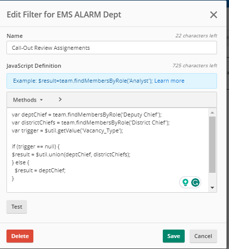

I have the following code:
var deptChief = team.findMembersByRole('Deputy Chief');
var districtChiefs = team.findMembersByRole('District Chief');
var trigger = $util.getValue('Vacancy_Type');
if (trigger == null) {
$result = $util.union(deptChief, districtChiefs);
} else {
  $result = deptChief;

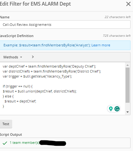

When I test the filter in the edit filter window with an empty Vacancy_Type value
The result is just the deputy chief variable and not the deputy chief and district chiefs together.
However, it generates the correct result (deputy and district chiefs list) when it runs in the instance. This isn't a big issue because when it runs in the instance it is correct, but it does mess up testing/debugging if I were to try to write a new filter script for something else and needed to test something I wasn't sure about. I looked to see if anyone else has posted about this issue but didn't see anything so I wanted to bring it up as a potential bug.

I wonder if it is the difference between a NULL value and an empty string in the testing?
What if this line:
Was changed to this:
if (trigger == null || trigger == '') {
Would you get the same result?

replied on January 29, 2024
Changing the code as you recommended made it so that the test window generated the correct results.

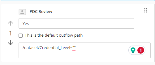

replied on January 30, 2024
To add to the above issue. I think the fact that empty variables are handled as null within the instance affects how they are handled in gateways. Several gateways have started to have issues since the update when the gateway condition is set to be taken when the variable is equal to ''. The screenshot example below shows the path that was supposed to be taken but caused a suspension instead.
